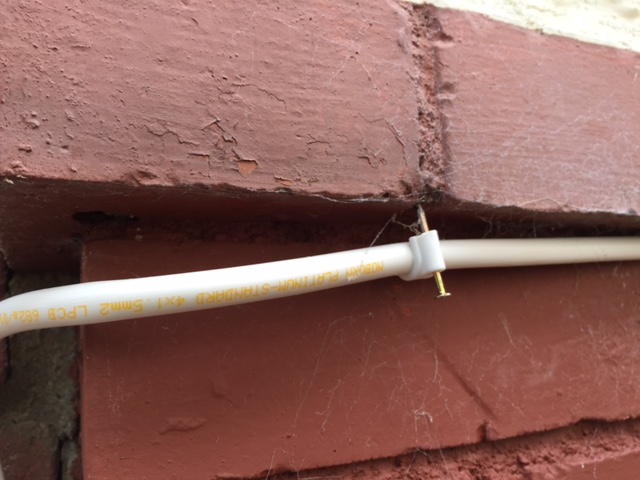

He advised I bought separate PIR and light. In hindsight I should have questioned it as it looks awful.

Pvc conduit would look better. Unfortunately he probably would make a hash of that though judging by the work he's already done.
That cable is not suitable for use outside, it is not UV stable or mechanically strong enough for the job. Not to mention its ability to wick water up through the cable by capillary action.
If you look at the bends you can see where it has been bent too tightly and the outer sheath has collapsed into the voids in the cable, this is also not acceptable.
Cable or PVC conduit installed externally should always be black and preferable a tough rubber sheathed cable. There are exceptions to this but they wouldn't be relevant here so I won't go in to it.
I personally would insist that the whole lot be removed and re-done with black TRS flex supported with black P clips and brass screws.
Separate PIRs (if chosen well) can be more reliable than the ones usually incorporated into light fittings.

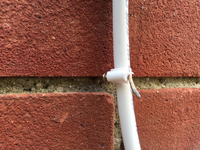

In this sort of situation, I tend to use black Hi-Tuff or NYY-J cable, fixed to the wall with small cleats and screws; three or four core as required. Judging by the raked pointing, there's a fair chance that the clips will start falling out before long.

Shambollock work. Pay nothing and make him do it again properly. hituff and/or conduit for me.
I cant help but wonder why anyone who was going to do it that way would fix the box halfway down thw wall when it could have tucked up high and saved all those loops of cable,anyone with an ounce of common sense........Oh,hang on,think I've answered my own question there.

Some more images for you showing how the clips have now come out of the wall. The cable is so thick the tension has pulled the nails out.
For the other light he has just clipped the cable to another existing cable that was already there.
