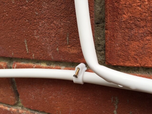

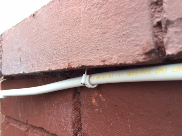

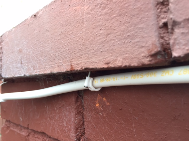

Some more detailed photos of the cabling for you... The reason he said he needed to use that cable was that as the wall got a lot of sun, normal cable would not last very long and would become brittle. He said this cable is UV resistant.
Don't think he'd like black cable clipped up his white walls!!
Then the electrician needs to find a different route for the cable.
The regulations, and common sense, require a cable which does not degrade in sunlight, so it's going to be black cable. Unless of course the electrician is going to use white micc
What a dog's dinner !

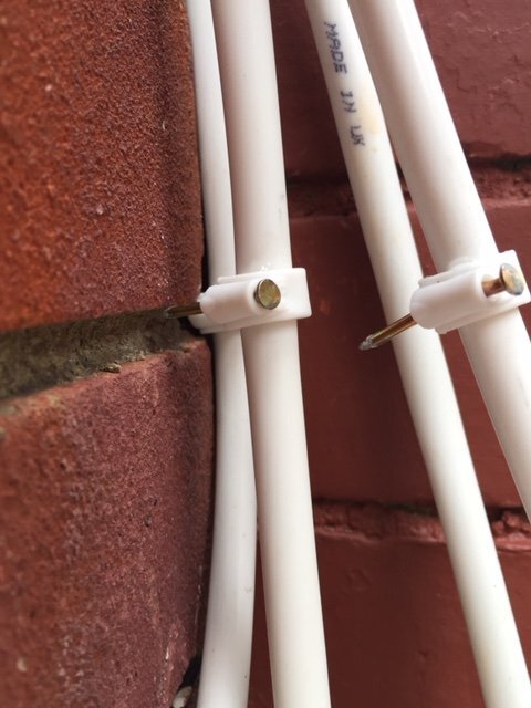

The clipping is unsuitable, the fire proof cable is of unnecessary specification, the cable bending radii are far too tight, the cable routes and choice of wiring method is appalling.
This has been done by someone who doesn't really know what they are doing and doesn't give a ---- either.

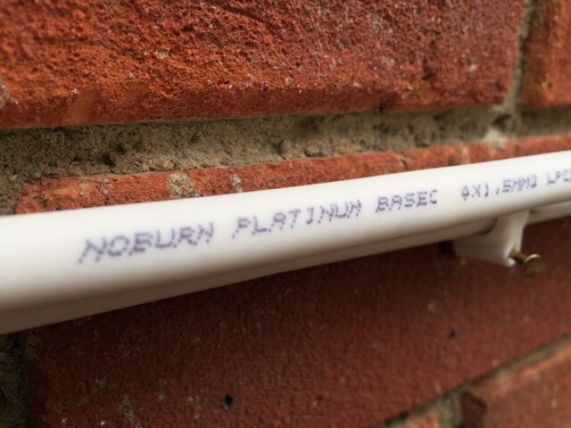

Why on earth would you use firetuf? That would be no better than what is already there, there is no need for a fire resistant cable in this scenario and it's tendancy to draw water up the cable through capillary action will be undesirable.
That cable is FP200 (type cable) 4 c 1.5 isn't it ?
[h=3]Are FP Cables suitable for outside installations?[/h] For external installation with exposure to UV, we recommend white or black sheathed FP. Do not use red sheathed FP outside without additional protection.

I never said I would put black cable on a white wall, I would do the job properly and route the cables in such a way that they are not unsightly.
Which type of FP are you talking about ? And what properties of it are you saying make it the right cable for the job? If it is FP200 then It is not mechanically strong, it has hollow spaces inside the sheath which wick water through capillary action, it is degraded by sunlight at a far greater rate than a black cable is (obviously excluding black fp200)

Not necessarily,despite what has been said I do not believe that there is any reason regulations wise that the cable is incorrect. That said it is an appalling choice on cost and aesthetics. There are far better alternatives than his choice. You have good reason not to pay him due to the unacceptable standard of workmanship,if he is selling himself as a professional electrician then you have a right to expect a professional job.

I think you should explain your concerns to him,that the work looks dreadfull,that the cables are poorly secured and already falling off the wall,and that despite what he says there are better alternatives. A black plastic conduit system professionally installed,or possibly Hi-tuff cable using screwed P clips as nailed clips are clearly not secure.
Given what he has already shown I doubt he is capable of either of the above to any standard,but you have to give him the chance to rectify the job. If he wont then ask him to remove it and leave without payment.

Terrible, conduit would have been nice and neat or run cables inside and chase fill accordingly, fuse spur for feed, with switch to energise switch live/trigger to linked PIRs. Or suitable fittings with ingetral PIRs. No excuse for sloppy work. Ask to remove and get some quotes from some sparks who take pride in their work.
I'm still at college and I know this is wrong. Should either be chased / under floorboards indoors or conduit outside for neatness and mechanical protection. Also I don't get the need for separate pirs, it just looks crap adding all the extra cabling and it's just not needed.
