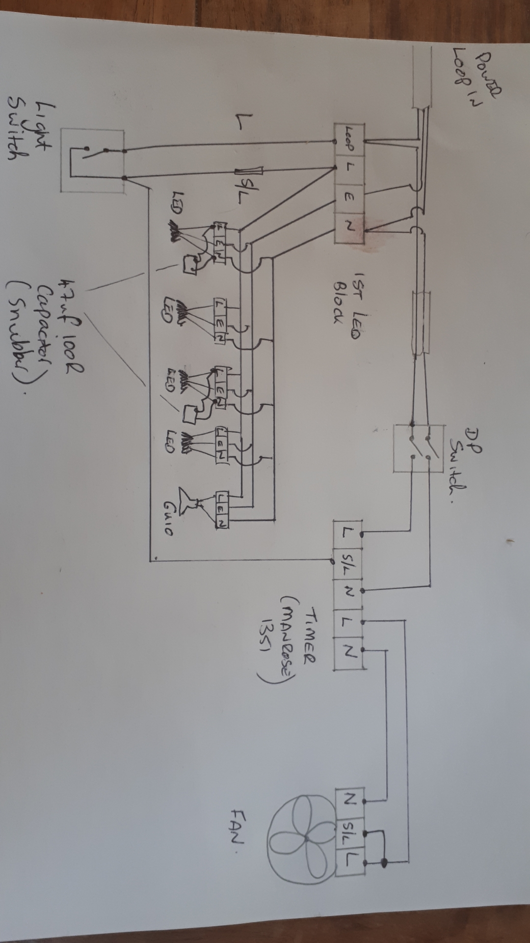

Good afternoon everyone.
I have fitted an extractor fan in my bathroom with an overrun timer, to start when the bathroom led lights are turned on. I have wired the feed to the fan via an adjustable overrun timer and DP isolator with the SL for the fan timer coming from the light switch.
The issue is with lights and fan off the LEDs are flickering dimly - this stops when the DP switch is opened. I assume there is a small leakage to N from somewhere in the timer causing the sensitive LEDs to flicker, which when the DP switch is opened cannot occur hence the flicker stops.
I have bought and fitted a 47nF 100r capacitor and connected it to all possible combos in the timer - no change. The only thing that stops it is if I disconnect the SL from light switch yo timer - but obviously the fan wont run now.
I have spoken to a qualified sparky who's only suggestion was the capacity action as a snubbed - he doesn't know what to do now!
I am stumped and would appreciate any advice please.

The timer is a Manrose 1351. The fan, buried in the ceiling! has a built in timer set to max (30mins), and i adjust the overrun time on the external timer. The supply to the fan isolator DP switch is last on the lighting radial. It then goes to the timer and the output from the 1351 timer to the fan. The 1351 timer needs a SL so I have taken a SL from the light switch to timer, to control the timer start function. Output from the timer then to fan. The fan needs a SL in its JB so i have looped the fan L to SL in the fan JB.
All functions correctly except the LEDs flicker dimly unless the DP switch is open.
I have two bathrooms with the same issue, all wired the same.
I tried to load a wiring diagram but it was 3.2Mb and it wouldn't accept it I'm afraid!

So the switched feed to your LED's is connected to pin 2 of the Manrose thing, they are less than 15W, and they don't flicker!
So much for my theory! 🤪
And I think that is where the problem is, Ghost voltage from the main switch, a snubber should sort it out, two way by chance?
The timer is wired as per instructions and ligjting load is 4x4.8w LEDs, and to act as a snubber I wired the shower light which is a gu10 as the last lamp on the run. I have also tried two (in case one was duff!) 47uF 100r capacitor across every combo of terminals - I'm baffled.
I'm going to try a 1 way switch at the light switch as I am using a two way but in 1 way config.
I really appreciate all the help and advice - I'm struggling with this one!!

I have, on the first LED in the run, where I switched them. I'll try one of the others now though. I have just changed the switch to a 1w as opposed yo the 2w that I was using - back soon!
I have fitted the capacitor across one oc yhe other LEDs and no change and swapped 2w for 1w switch.
Put on an additional snubber and re-draw your sketch.

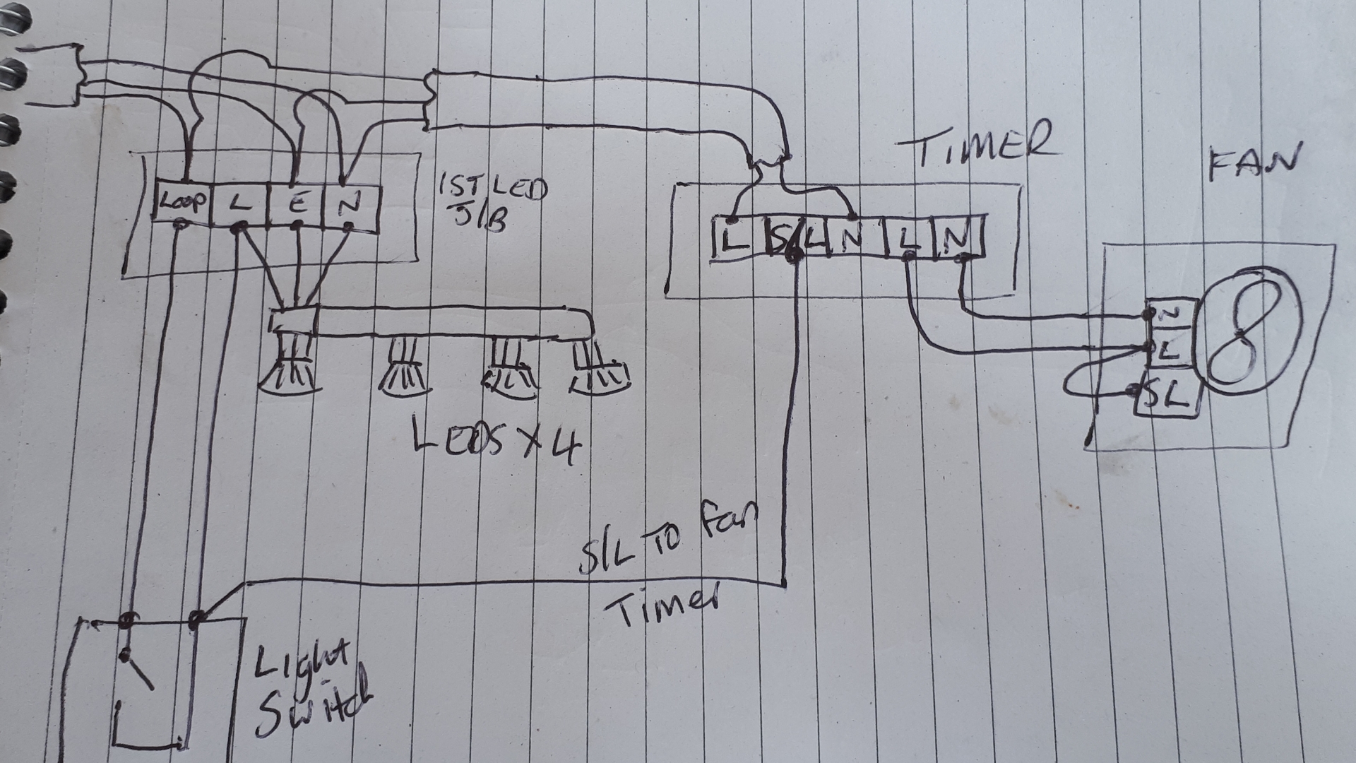

Mike, please see a better diagram. I have now fitted two capacitors (only have 2) and no change. I would have thought two capacitors and a gu10 should quash any stray V? As soon as I disconnect the timer SL the flickering stops. Can I fit a 10a 250v diode to stop any voltage leakage back from the timer SL to the SL connection at the light switch, which is the only way I can see and voltage getting to the LEDs.

Is the S/L from switch to timer accessible? Would it be practical to use a 2 pole light switch and switch the timer S/L separately from the LED's? That would obviously stop the problem!
Could you confirm if the GU10 is LED or halogen. If LED could you try a halogen?
Sorry about all the questions - your circuit diagram rather neatly separates the wiring of the timer and fan from the wiring of the lights, but in reality are the physical cables jumbled together? That could lead to an induced voltage being the problem.
But if they are actually separated, I'll stick with the suggestion it might be the timer creating the voltage.

Good morning everyone. As mike suggested I disconnected the SL at fan - no change.
I have fitted a different timer - no change.
Cables are not particularly close or bunched - so I think unlikely it's inductive from an adjacent cable.
Showing between 7v - 11v between L/N at one of the LEDs.
I have wired a pendant with 100w lamp across one of the LEDs L/N and problem gone, but obviously I can't keep that there!
I'm using .47uf 100r capacitor as snubber, but are these large enough (or whatever), as the 100w lamp appears to be able to dissipate the stray voltage.

Have you tried disconnecting S/L from the timer and measuring the voltage on the 'Manrose' S/L terminal (if any).
I'm presuming all the lamps (by which I mean the bulbs themselves) on this circuit are mains voltage, there's no led driver or electronic transformer on this circuit, no shaver socket or charger, or anything we're missing?
It would help me if you could disconnect the entire LED string (complete with the shower light) from its supply, eg at the terminal block or whatever it is that you show in your diagram, and measure the resistance of the lamp chain between L and N. I would expect it to be very low, eg 10 or so ohms with the shower halogen bulb in circuit.

I think Mike is right, it just needs more snubbers until the effect goes away.
The voltage at SL is 11.4v.
All LEDs and halogen, 2 snubbers and 100w lamp - approx 100M ohms
All LEDs and halogen, 2 snubbers- 90M ohms
All LEDs and halogen, 1 snumber- 100M ohms
All LEDs and halogen, - 120 - 150M ohms.

The 47nf is maybe a little low. I think 100nF (0.1uF) or more with say 120 ohms in series is the usual sort of thing.

@clanky boy notwithstanding any of the last four pages, somewhere you have a Ghost voltage on your supply to these lights, this can be caused by many different reasons, but usually its a two way switch somewhere on the loop with an induced voltage between the two switch's, a clean supply or snubber/snubbers are the only way to cure the problem IMO.

Mike, apologies for delayed reply, but I finally got round to fitting the snubbers today. I got 8 x .1uF 120ohm and fitted all of them, one more each time. It has vastly improved but problem still there - that equates to .8uF and 960ohms! I disconnected them again and tried my 100w bulb again - problem goes instantly yet it equate to 500ohms and .41A, if my maths serves me correctly. Am I missing something or do I need much bigger snubber(s) say .22uF (220nF),470ohm snubbers- your thoughts please, kind regards, Mark.
There's got to be more to this than just needing more and more snubbers chucking at it surely?
Not sure what though I must admit.
The snubbers need to be on each individual light not all bunched together, see post No 39 that is just one light connected at the lower end of the junction box.
Its the bulb that is picking up the Ghost voltage not the circuit.
