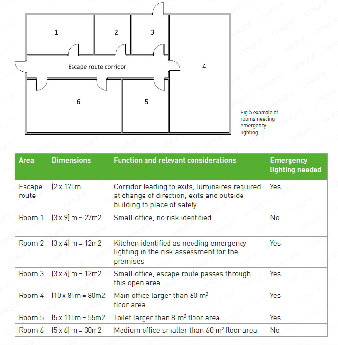

Attending a job the other day in a shop. The shop is 20m long and 10m wide. There is an office/store/kitchen at the back leading to a communal store and passageway for four shops. Each unit locks its own door to this communal area.
The fire officer has told the owner there is no need for any exit lights at the back or front. I was somewhat surprised at this. Is there a need or is it too small to need emergency lights? I know I plan to go on a course at the end of the month and should have the definitive answer to this but in the meanwhile...
Pinched the below from this info.
Looks like anything larger than 60m² may need one.

IT may be that the emergency lighting is nessicary. It's just the exit signs don't need to incorporate lights.
Reactions: MDJ and Vortigern
The site should have had a fire risk assessment which will note the requirements for safety services.
If there is directional signage it requires em lighting.
If the fire officer has stated that there is none required in his report then none are required, he has his signature on the report. Nothing stoping you going beyond his report and adding extra tho aslong as the client is aware imo.

I would like to actually hear what the fire officer said because the absence of emergency lighting in a non domestic premises is highly irregular.
Really depends on what the FRA states.
If the shop is only going to be open during daylight hours and there is a sufficient amount of natural daylight entering the shop then why would emergency lighting be required?
