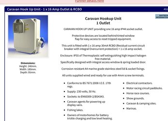

Is it ok to fit theses caravan hook up power supplies.
Concern that the rcbo only disconnects the Live conductor.

I would prefer either a D/P RCBO or a RCD + MCB.

It is a requirement for the rcd to disconnect all live conductors this would include the neutral. See Regulation 708.415.1

Thanks,why are they selling these then.
if they supply the caravan,& this caravan as got a Rcd DB, would that comply.
All the caravan sites I have done have had double pole RCD or switched neutral RCBO!
The caravan is a separate entity, the socket installation must comply with Section 708.

If you want to isolate the caravan on line and neutral..... you could just unplug it.
