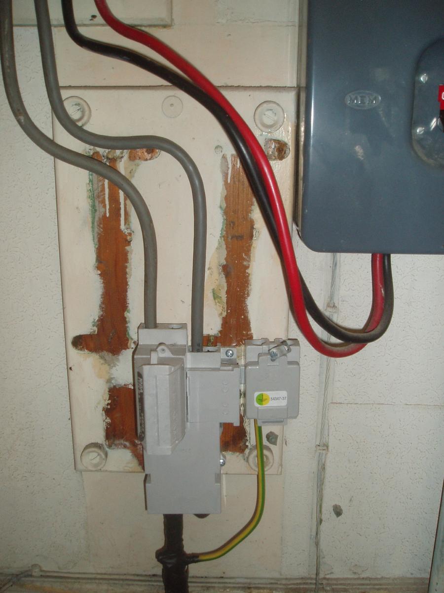

DNO upgraded this head end 7 years ago so what do you think is missing ?
Both actually the customer had no main earth for 7 years because the guy who fitted it mumbled something about getting an electrician out to look at the main earth now that was last year I was called out to another house recently with the exact same fault. Me I think its criminal but then I have to realise that they are above the law so for anybody thinks we have come a long way since the dark ages should think again mind they have not got the time to pass a law that says leave an installation in a safe condition and for the price and time of a 1 metre length of 16mm green and yellow cable
