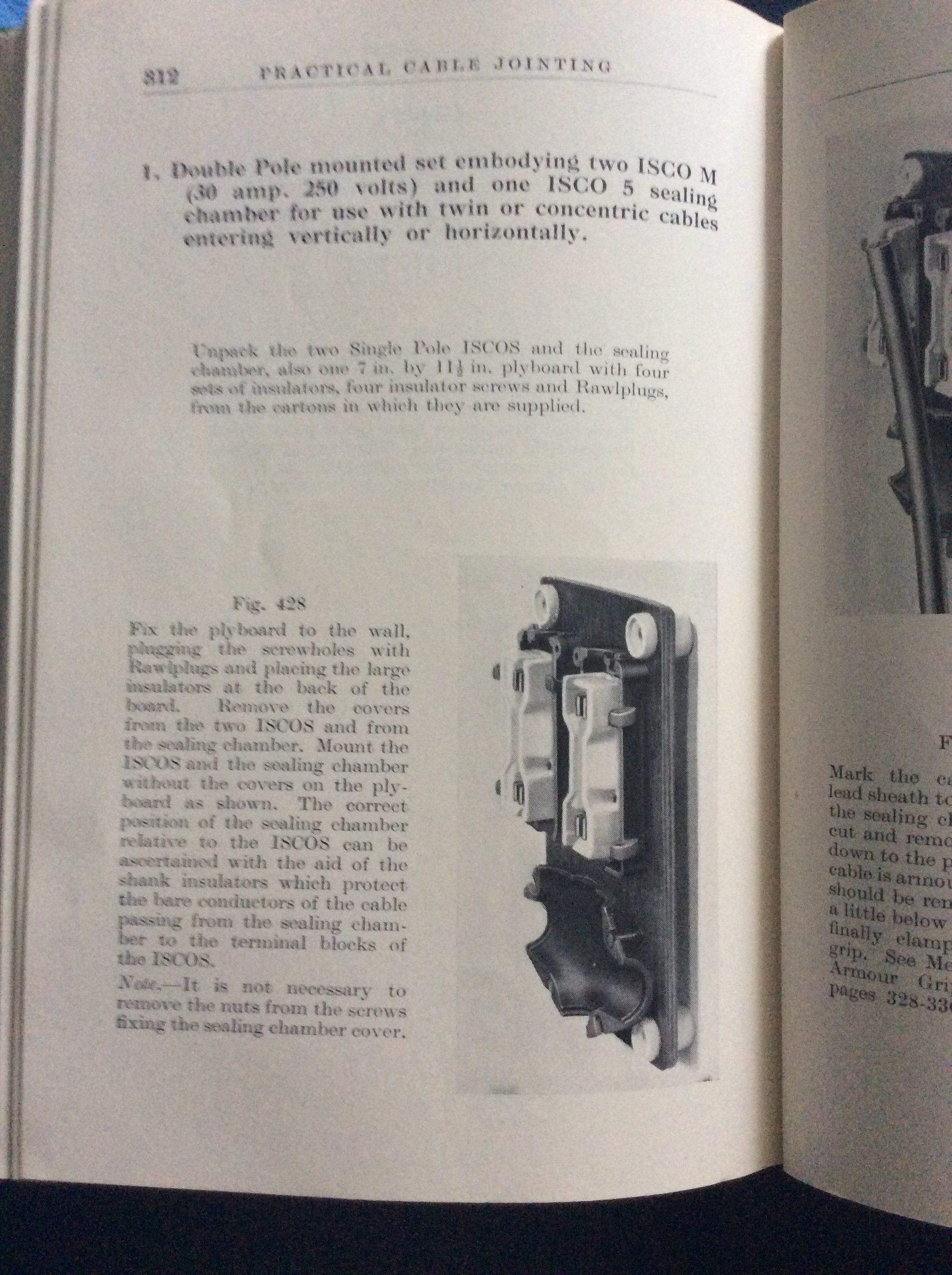

ISCO was a product of WT Henley, I think it stands for Ironclad Service CutOut
Reactions: DPG and Dave OCD

That book looks really interesting Dave, see they had an emergency head office at the time, most likely the usual one was a victim of German bombers , and the new type backboard insulators mentioned musn't have been favourably received - I've never seen anything other than porcelain insulators on backboards ?
Reactions: HandySparks
I'd never even considered that was why they had an emergency head office, but it seems obvious now you say it!
I don't honk I've ever seen anything other than porcelain either, weird
Reactions: Dave OCD
