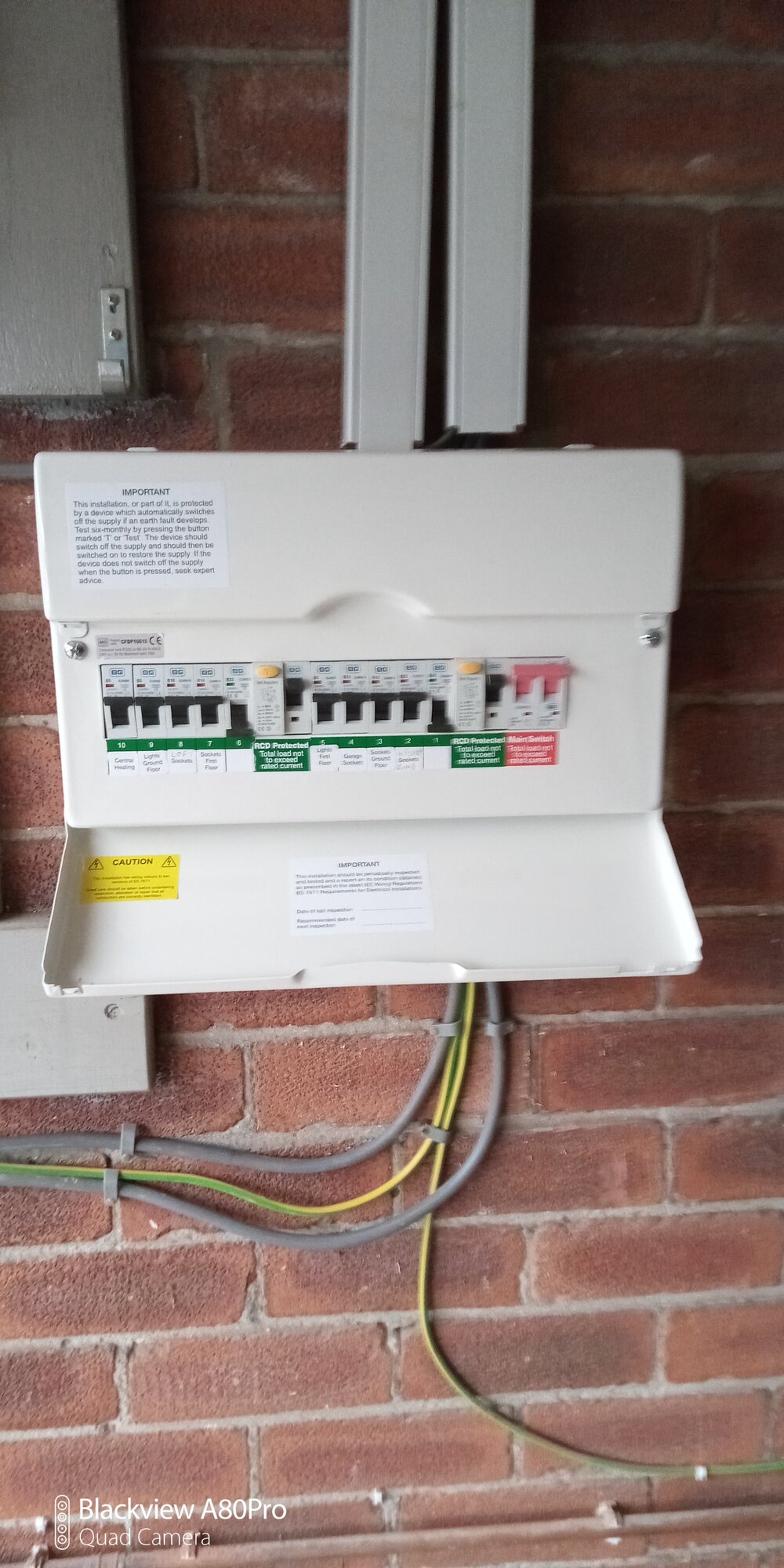

Still want to see what the consumer unit looks like.
Take Tel up on his offer… he will be able to tell walking into the place whether it’s been a good job or not… no need to dismantle anything really.
Thank you so much. I have attached images of the consumer unit. What I have not explained so far is that the main contractor left his son and an apprentice on the job. His son assured me he was qualified/experienced and I trusted what he said. I am not out to damage anybody's reputation but just want as much fact as possible before taking the next step. I will get Tel to look over it and give me a second opinion. I am hoping it is not as bad as it appears and can be rectified without tearing my house apart again.
Let the scheme deal with it glad they have given you a positive response.
That trunking at the top of the consumer unit is rough.
A close up if the bottom of the consumer unit would also be interesting, to see what sort of a gland or grommet they have used - hopefully it is not cables resting on the sharp edge of the metal.
Not as rough as the tails.....with T&E clips....well, perhaps not.
I'd love to see inside that board but not worth the OP risking taking the cover off . Work of this standard really infuriates me ,I genuinely feel sorry for the OP, particularly with the history and sentimental value of the house.

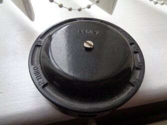

Of course everybody is assuming that the exposed terminals are part of the rewire and not the original wiring.
Just saying.
  • Agree
Reactions: James
Agreed but even if they are original and now unused cables, I would expect to see them in an enclosure
Just saying.
Even if by some twist of fate that birds nest joint was the original wiring , Imo any sparks worth their salt during a full rewire should of at very least put it all in a choc box or adaptable box
Reactions: DPG and James
That's not really suitable for a joint under the floorboards either though🧐

I have to say after reading through the thread from the start until the picture of the consumer unit, I was fully expecting to see a BG split load board.
Haha I was going to say the exact same thing, as soon as you see a BG split load board with no SPD on a new consumer unit you know its gunna be rough... Cheapest consumer unit Screwfix sell.
Personally I just don't give customers the choice, I fit Hager, if they want something cheaper they can go with someone else, clearly this is the result.. Worst thing for the OP is I bet they weren't cheap either.. I know as electricians we always moan about other peoples work as we all like to do things our own way etc but I think we can unanimously all agree that is as rough as old boots, how have these people been allowed to continue in the industry, I blame the CPS's, NICEIC should not be suggesting the customer make an official complaint to the company, with such poor workmanship they should be coming out and checking and then chucking that company out of their scheme and banning that person from joining and telling NAPIT about him so he cant join them.. But of course they just want their money..
Just reading the Toolstation flyer that arrived by post offering "18th edtition" Contactum CUs dual RCD without SPD. Really?
1. SPDs are optional,not mandatory.
2. I've fitted dozens of BG dual RCD CUs and they've been fine. only gripe is cover can be a bit awkward to fit.
might not be the best quality, but ranks high on the value for money scale.
another small gripe is the internal tails feeding the RCDs. in the wqy. i usually take them out to wire in the circuis, then refit them after. sometimes i even get them in the right order.
