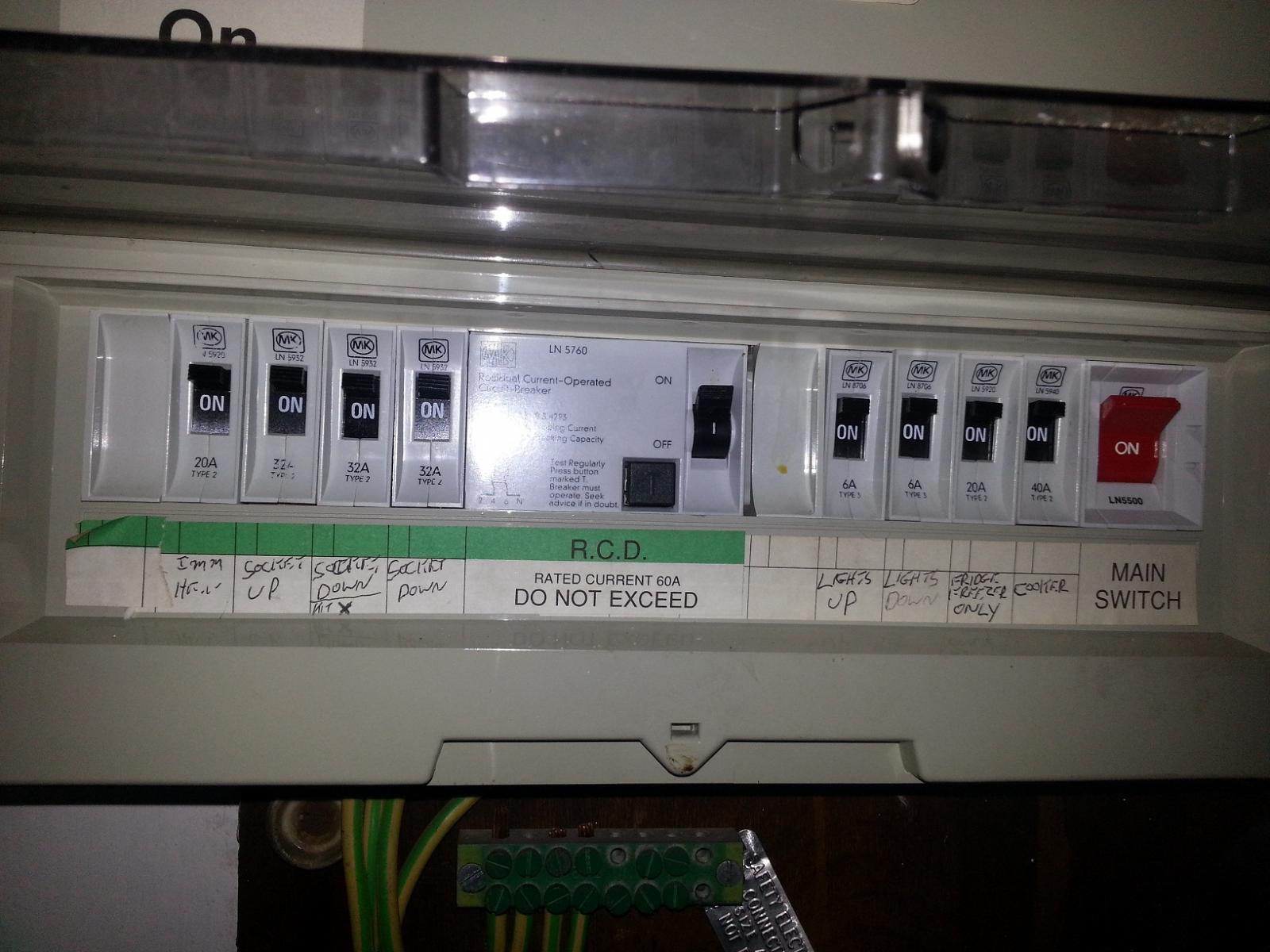

Another thing... Aren't you meant to use 4mm on radial circuits, just in case someone comes along and adds more socket outlets? Especially if you end up using a 32a breaker in the garage.

If you have designed the circuit as a radial, and put it's max design current as 20A, then 2.5, under normal conditions, will suffice. If someone wants to change the design to increase it to 32A, that's not your problem. If they add more sockets the cable is protected by the MCB. (How many sockets can you have in a garage!) If the circular saw inrush current looks like it will trip your 20A breaker, use a type C. Hope this helps.
