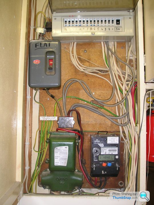

when you guys say "iron clad" do you mean these sort of things....
What is the problem with them? I hear somewhere they contact asbestos, is this true?

Is that red/blk going into the meter and brown/blk out?

Never mind the asbestos, that probably has a re-wireable fuse link.
Get the DNO in to change it. Pronto!
The amount of asbestos contained in a re-wireable fuse carrier is miniscule. This whole thing has blown up out of all proportion.
