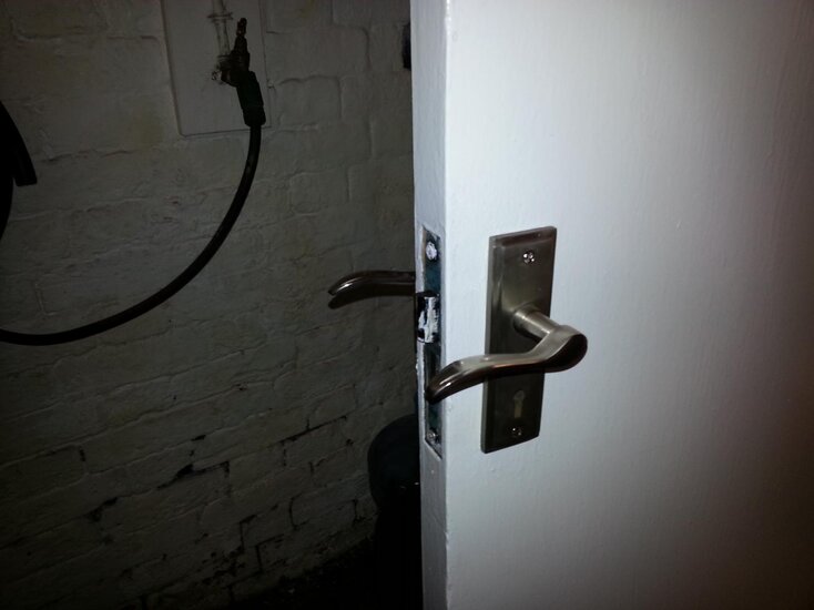

Builders and Joiners are as bad this is the calibre of the tradesman i worked alongside a few months ago, can you spot the mistake because he couldn't( Div )
Reactions: 10 people

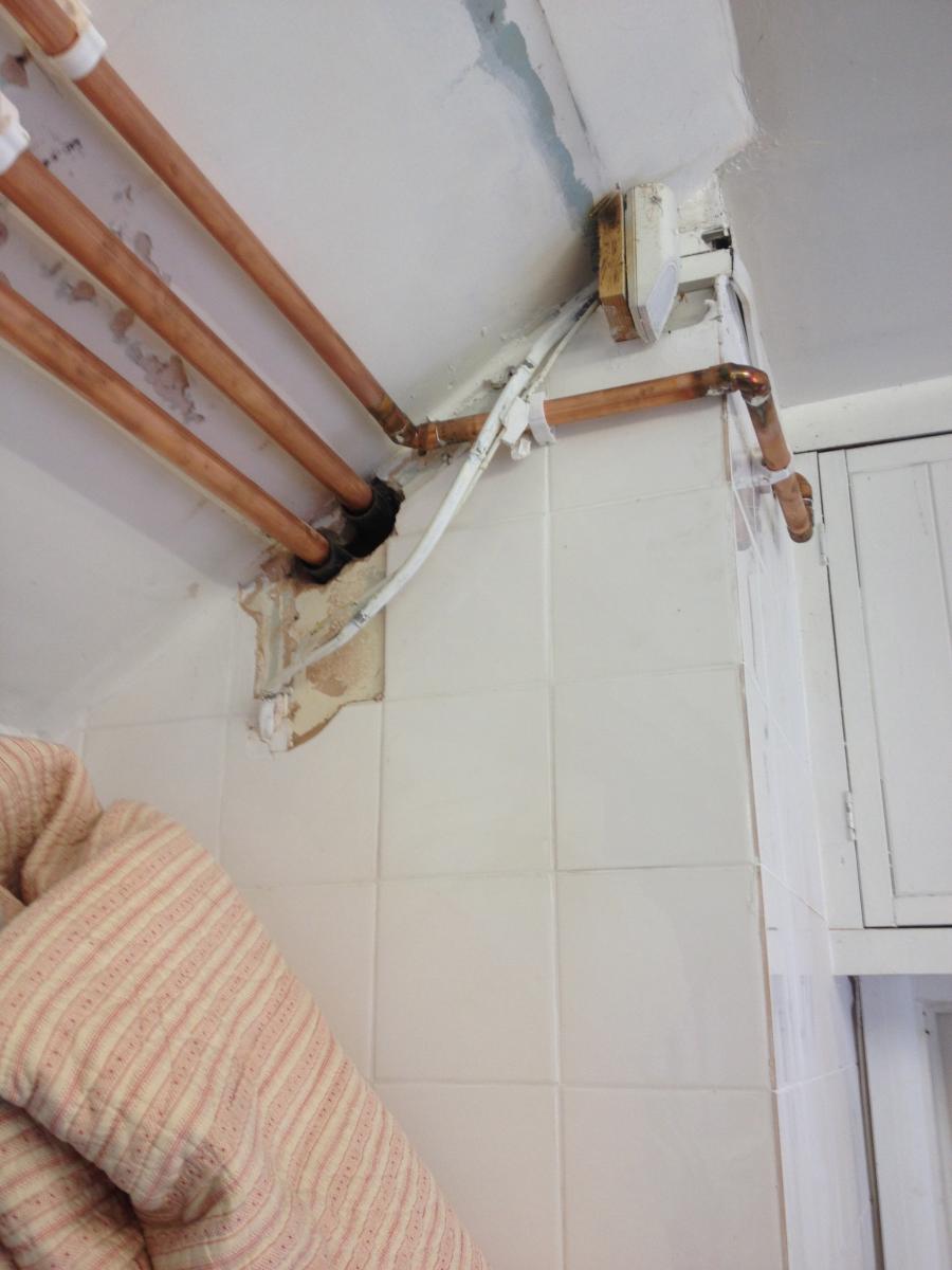

Existing wires , new pipes
