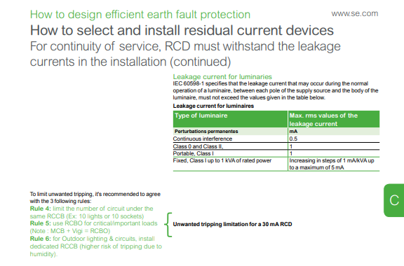

According to the latest version of the regs (the 18th) RCDs should not operate at more than 30% of their rated trip current (usually 30milliAmp max so 30% would be 9mA which is 9 millionths of an amp, for reference the smallest fuse in said house would be 3 Amp and the smallest MCB is likely to be 6 Amp)
Attached is typical expected leakage currents.
