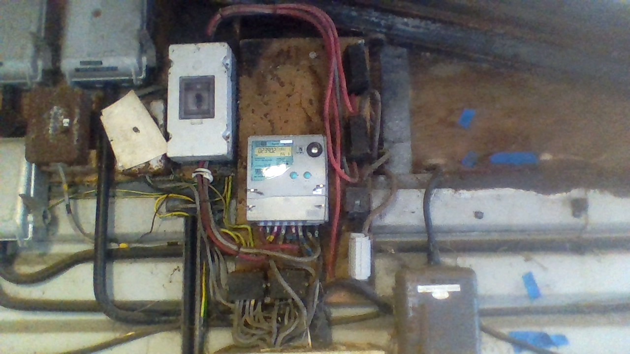

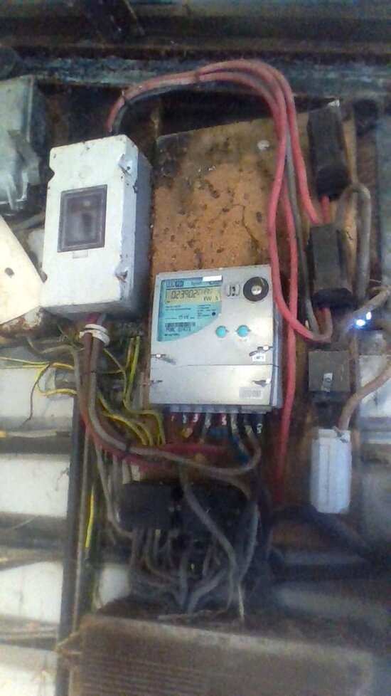

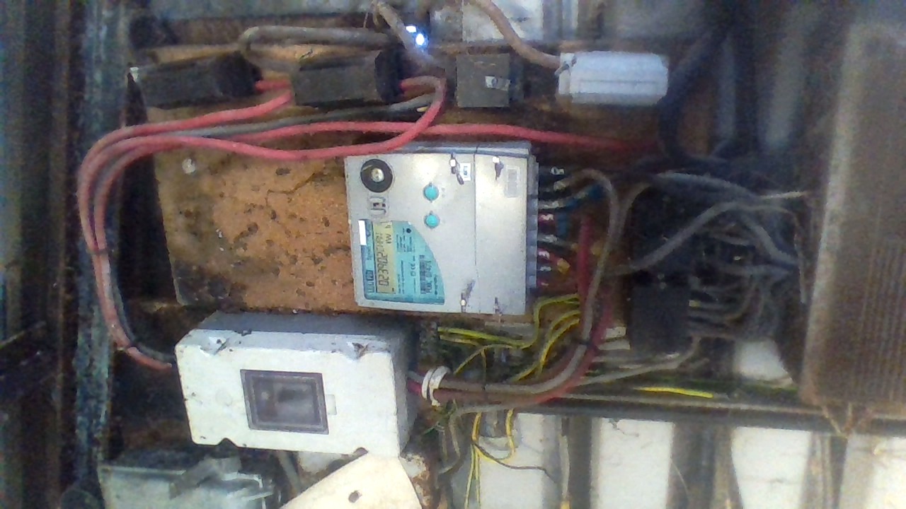

I went to look at what supply we had to work with , for a new grain store that one of the local agricultural dealerships , who we work with is quoting for .
Can you spot the mistake !?
well the pictures are pretty poor and what can be seen generally looks a mess.
from what i can see the isolator isnt on the consumer side
I'd agree, the isolator looks to be before the meter.
It could do with a bit of a clean up but I have seen worse by a long way , and yes the rcd is before the meter .
It is in a old Hosier prefab milking parlour , which is pretty much just a big tin shed .
The only thing I can say is about the isolator, but the whole thing looks to be a mess.
Is the isolator before the meter an actual rag? I thought it was just a DNO specification to stop 'tap offs' before the meter.
I got it. No RCD test label??? Sometimes the answer is looking you square in the face?? Lol!!
I like it how the meter boys have been in and fitted a new meter and what looks like a new fuse and carrier , and sealed all of their gear back up , but just walked off and left the old rcd in line without a second thought !
I would say that you are correct , but then again being on the company side of the supply it is out of bounds for us anyway .
I wonder if , even resetting it after a trip could constitute tampering !?:willy_nilly:
