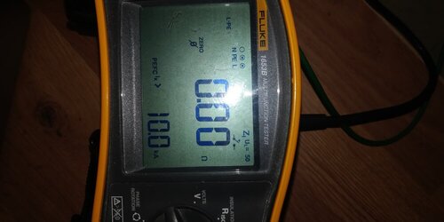

Hi all,
Hope you are all well.
I went to do an EICR at a small domestic property supplied by a TN S today, it is wired in singles using the conduit as CPC, however, there are no lugs for fly leads to sockets or light switches. In itself, what does this warrant, C2 / C3, there are only class 2 fittings in use?
Also, upon initial check the incoming fuse carrier was smashed and needed replacing, also Ze was 0.00 with a PFC / PSCC of greater than 10 KA. I advised the client to call DNO to replace fuse carrier, sort the earth and fit an isolator, tbf they atended within a few hours, replaced the fuse carrier, but left the main earth terminal off and said to the client call me back and I can put a clamp on it, rightly or wrong, I revisited and clamped the main earth, however, carried out the Ze again and the same reading is achieved.
Can someone help explain how and why I get that reading and more importantly, how I resolve it?
Many thanks in advance,

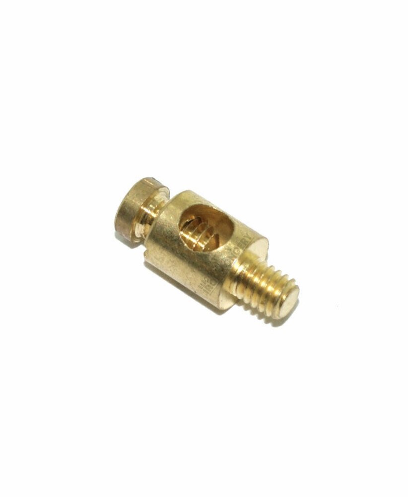

Do the back boxes have earth terminals.

Re. The high PEFC, I don't know that MFT but it looks like it has a test lead resistance null function active. Does this apply to the cable used for loop impedance tests? If so, you might have an incorrect null programmed that is offsetting a higher resistance than the leads fitted. This will cause it to under-read the impedance and overestimate the fault current.

Well of course, what @Lucien Nunes said, and @Strima i.e. close to the transformer causes low reading. If you look carefully in your manual you will see the figure for potential error in your reading. i.e. it can be (often) 6 figures higher or lower. Meaning, 0 could be plus or minus six, therefore your reading of 0.00 could be 0.06 which can be seen as 0.1 which is not an unusual reading. If you got 0.00 then I can't quite work out your fault current you came up with as 230/0.00 is 230 or in fact cannot be divided by zero so a bit puzzled by that. But if we said 230/0.1 then 2.3Ka is your PEFC which is entirely reasonable. Also as I did ask, was ATT on or off? And knowing how we all like to be acknowledged it is of course @westward10 who also picked up on the BS951 clamp in the first instance and should accordingly be noted in the annals!...that is one n /sigh

Nope, literally just box with conduit feeding.
What sort of back boxes are they, the round standard circular type with a square box on top? - if so the standard circular conduit fitting has a m4 threaded hole for the earth connection.
If it's a standard steel backbox with the 20mm knockouts, they usually have a brass earthing terminal - so I guess not one of these.
The very old type usually has a clamp type fitting to the conduit, and no earth terminal, these quite often don't have a good earth continuity after this length of time, so some boxes can end up with high r2, others ok; in this case it's almost inevitable that you need to pull a cpc to provide proper connectivity
If there are no cpcs through the conduit the BESA boxes are not likely to have metric threads, probably BA and they may or may not have a threaded earthing point in the back.
The imperial boxes used 5/8, 3/4 " main threads and usually 2BA threads for earth and cover ( though some had 4BA)
But yes even older ones didn't have a threaded earthing hole, but at that time, most of the conduit used for residential used clamp type boxes.
