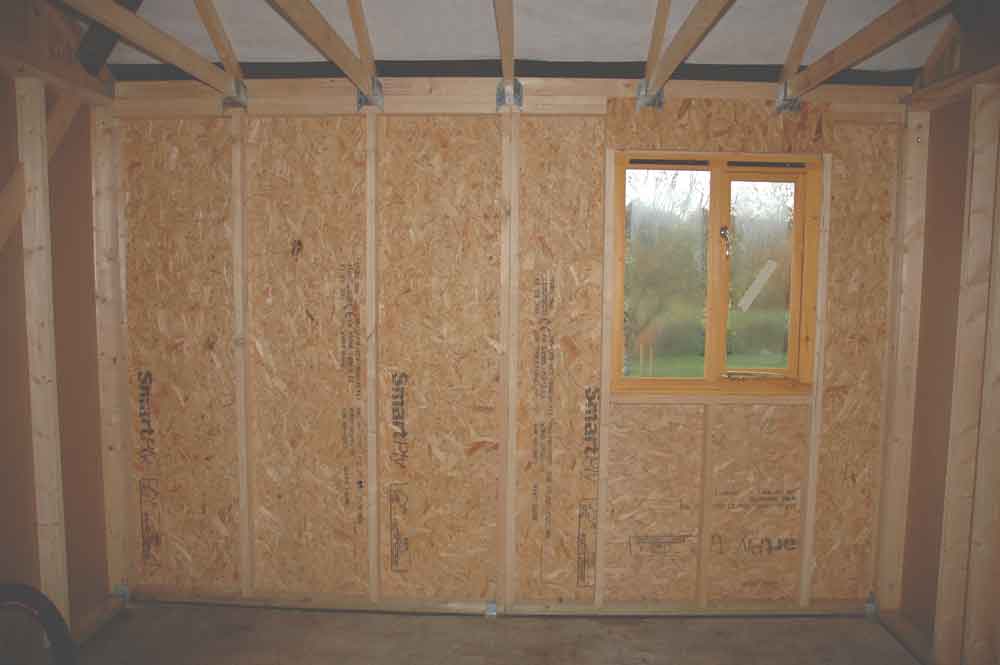

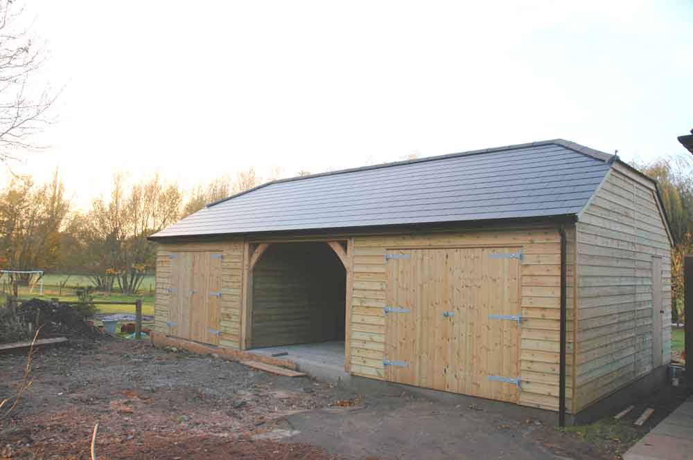

Here's some pictures of the barn.
It's a garage really in the shape of a barn.
So I guess the relevent question also is whether plumbing in a new "building" on the end of an existing SWA cable is notifiable under Part P?
