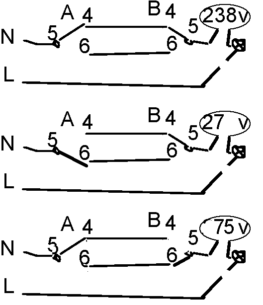

So now confident that the light must be fed through the other switch I disconnected the corresponding 5 on it and measured voltage between 5 and the wire that went in there FIRST and to my astonishment it reads 238V.
The light is not connected. Even the fitting is not. Only the fitting socket with the metal bars with holes. If it has voltage on both ends, I can't make sense out of it.

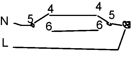

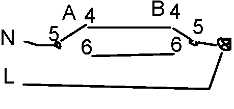

I thought the layout was like this
With bulb removed there should be no voltage between wire and terminal when unplugged.
Why does it have voltage at both ends?

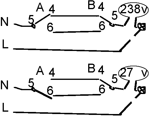

Now if I flip the switch on socket A to 6, it reads 27V on the terminal 5 on socket B and the wire going to light.

Here is a new diagram of how it appears now.
Since you are measuring with a high impedance multimeter, the above is to be expected!
You have mains voltage with the switches closed, ie both 'on'
You have a 'ghost voltage' with them in the 'off' position, and that is because the parallel wires running from switch A to switch B have capacitance between them, and that is coupling a bit of mains to the other wire. The capacitance won't provide much current, so the voltage would disappear if you used a lower impedance measuring instrument.
Normally L and N would be the other way round, ie switches in the live side, and you can't always go by wire colours, but it might have been wired the other way?

Yeah but the problem is that the other light does not exhibit any cycling resistance. I understand that there could be a voltage drop over the wire and the meter would show the difference across the probes. Especially as you say, the impedance is high and the amperage or power is low, hence the noticeable difference.
But it still means there is a leak somewhere. I just wonder if it is between switches or between switch and the light.
If you scroll up to my updated diagram, it now shows 3 different states of the wiring which show three different voltages.
What other setup can I measure?
I tried amperage of that 27V and it read nearly nothing. At least it does not consume much electricity.
The hole between L and the bulb is on purpose because there is no bulb there. I could have deleted the bulb but I want it to show where is source and where is consumption. Sorry, I am making up all this terminology because while I understand the physics, I do not know what they are called.
