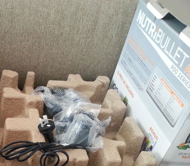

I've attached a pic of the plug:
As you can see, it's round and the plastic seems like one seamless thing. It looks like it might fit that Schuko plug you've mentioned though
Ahhhh, I think that might be an Aussie/Kiwi type plug, it's not a Schuko which was my first thought. It also appears not to have an earth connection. Can you give an exact make and model number for your appliance please, I want to see if I can fine a pdf of the installation guide. Where did you buy it from?
Yes, that's either Aus / NZ or Chinese (the Chinese plug is theoretically different but interchanges with Aus). The supplier should not have sent it to you like that, as it contravenes UK regulations to supply any domestic equipment without a suitable UK plug or permanent safety-approved adaptor fitted.
I strongly agree with Marvo that you should fit or have fitted a proper UK plug. Although the appliance does not need an earth, there are still safety issues with many travel adaptors, some of which are in themselves highly dangerous unapproved imports.
Thanks for the confirmation Lucien, I didn't have time to go and look it up. It's a bit weird that companies are supplying appliances with non-UK plugs.
When you first posted I thought it might be a large appliance but I see from the photo it's actually quite a small juice maker type thing, I'm sure you could take it to a shop somewhere and purchase a 13A UK plug and persuade them to fit it for you.

The plug you have won't fit into a Schuko adapter. The pins on your plug are flat, Schuko plugs have round pins so the adapter I suggested before I saw your photo won't work.

The plug will not fit a Schuko adaptor. There are adaptors for your type of plug, I am not going to recommend one but if you search, look for one that only takes your type of plug, not a multifunction one. Ensure it is fitted with a BS1363 fuse, has the two smaller pins sleeved but not the large earth pin, and meets BS5733.

I would suggest a 5 Amp fuse would be appropriate but personally I wouldn't lose any sleep if it was any other size.
If you cut the original plug off and strip the cable you'll probably find there's only 2 wires. If it's standard colours then the brown is live and the blue is neutral and there will be no earth.
You may however find different colours because this model was originally intended for non-EU distribution so let us know what the colours are in that case and we'll point you in the right direction.
