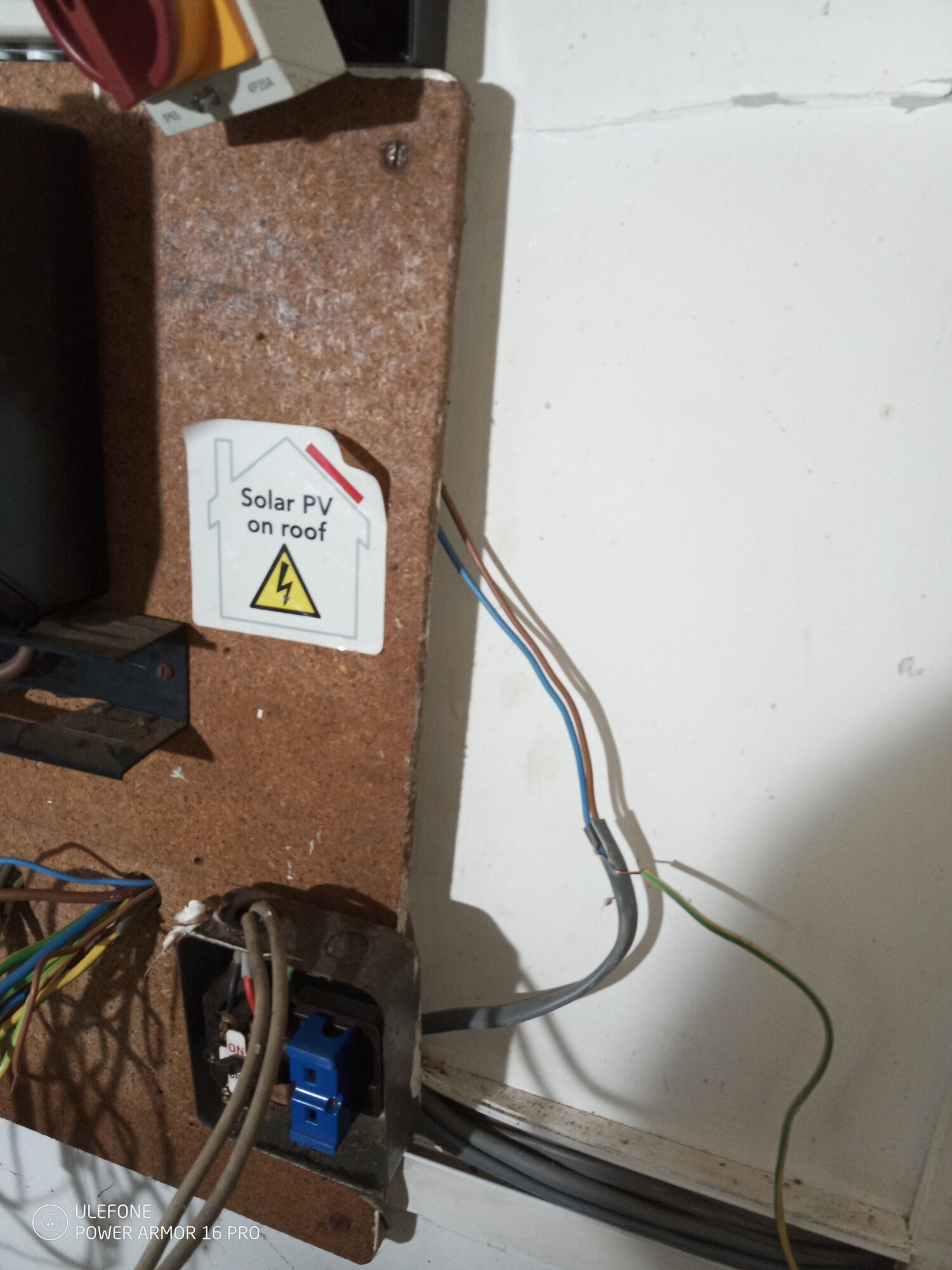

I've done the board change on this now, what a lash up it was before, old 16th board hacked into a dual RCD one, think they have taken the main switch out and put it in an enclosure outside the CU, then bodged another RCD into the unit and bridged the two.

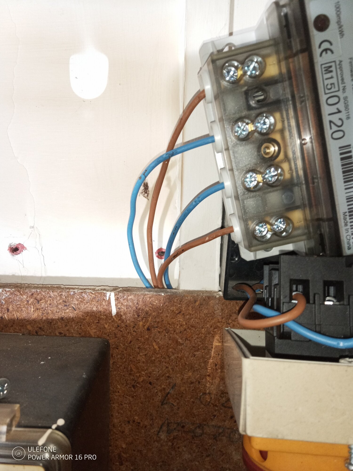

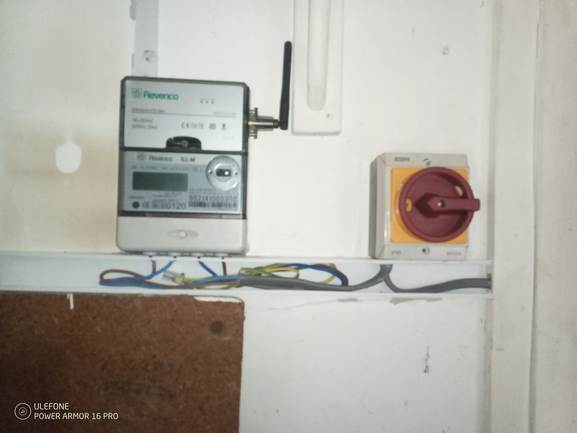

Solar wired in T&E but it needed to go through a meter so just strip it back until you get singles, great idea. L&N to meter, cpc to consumer unit.
I did what I could with bits in the van.
However is it wired right? the way they had done it was the feed from the inverter went to the meter input first, then out of the meter into the isolator and then to the MCB. I thought that was wrong and the inverter feed should go to the AC isolator first. That way if you want to work on the meter you can switch the isolator and MCB off and its totally isolated but I might be wrong.
Also the T&E to the inverter is in trunking so I don't think it needs any sort of RCD so for now I've just put it on the unprotected side, I've not even found the inverter yet let alone know what make it is so have no idea of any specs, I suspect its in the roof void somewhere but its a biddy bungalow, the roof is extremely low and I'm extremely big and the loft hatch is in the lowest bit of the roof.
