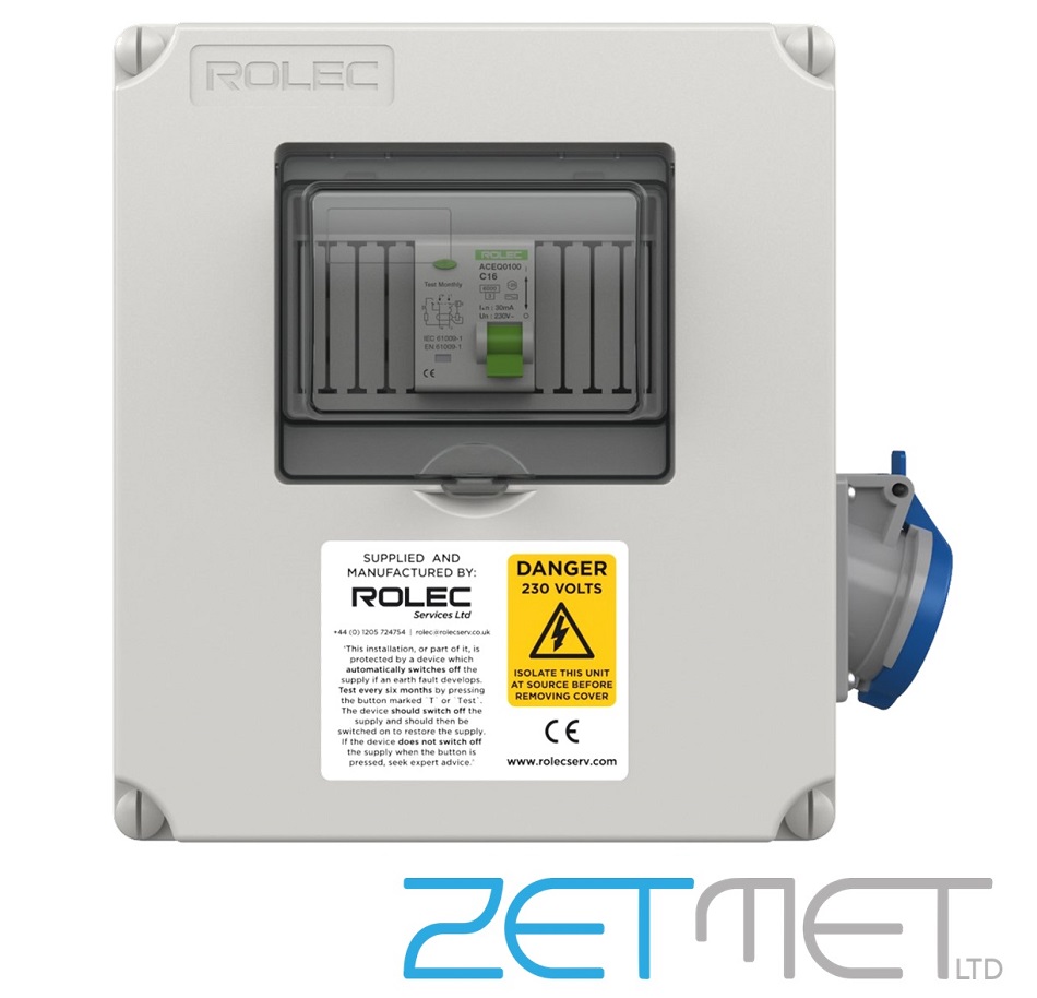

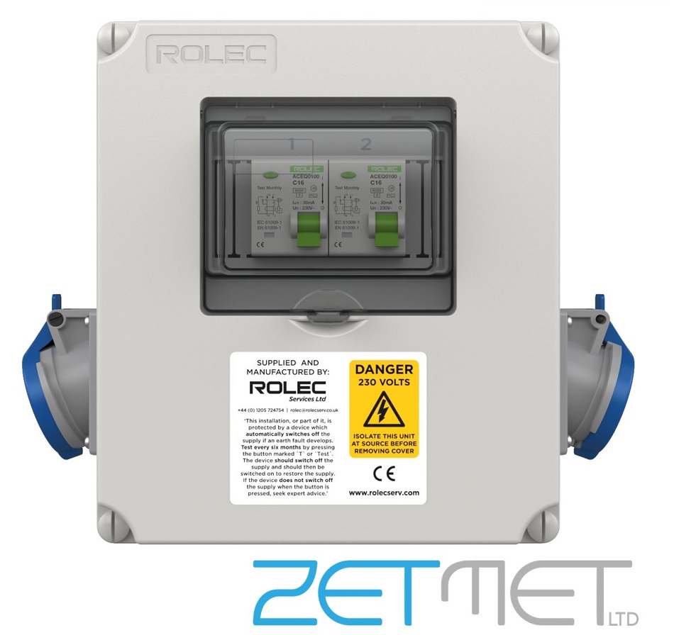

These are supplied at the hookup unit.
I'm fairly happy with the regs side of the job, I'm just trying to fathom whether I treat the circuit feeding the hookup unit as a 32A load, or if I can apply some diversity to it
Why do you need a double outlet ?
All the touring hook up sites i have seen have been single outlets with 30ma rcd and 16amp mcb.
Also, all the Consumer units in the caravans / motorhomes i have seen has a 16 / 6amp MCBs and 30ma rcd.
There's been regulation changes lately, and interlocked switched 16A sockets are now required with individual RCDs, which are usually RCBOs.
The usual set up is dual units, mounted on the dividing line between two pitches, or quadruple units mounted on the + between four pitches.
16A MCBs are OK, but 10A limits the possibility of customers taking the *iss with continuous heavy loads.

As @brianmoooore said, it's 2 pitches, side by side
