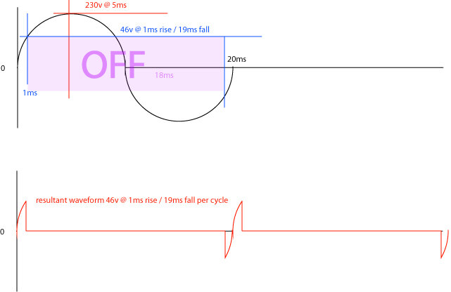

OK, this is nothing more than a guess based on experience, not a definitive answer, BUT.... I think what's probably happened is that the PSU hasn't enjoyed the chopped dimming output.
What most people tend to forget with thyristor dimming is that you aren't 'reducing the voltage'. What happens is that there's a timing circuit which fires the thyristor on/off and stops the waveform as a definition of TIME, not voltage. It's easier to explain with a drawing which I'll do in a minute! What you end up with is a waveform with all the smoothness of my chin after 2 days not shaving (hence why they interfere with things and buzz) and most things electronic won't like them. If you dim at 50%, you effectively create a voltage at 100Hz (kind of, it's a bit gappy).
This shows the cycle of dimming by firing a thyristor (although it's actually in reverse so you're turning it off) and the resultant choppy waveform. It's a bit simplified and it's not going to win any drawing awards, but hopefully may help to explain!
Big thanks matey....I can go back to then now with a bit more ammunition....It's a bit of an awkward one though,but I really think the commisioning guys are going to have to swallow it.
