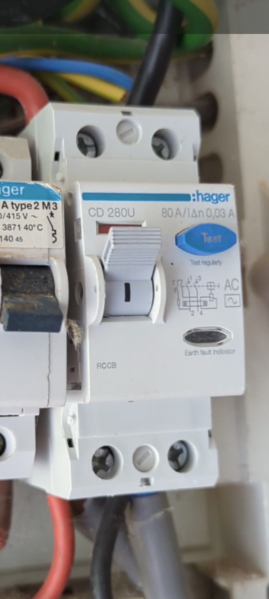

So the Hager RCCB in question. Pictured.

Sorry. One more. So the RCCB in question. Pictured. Has two visual indicators on it. One marked earth fault indicator. Not all RCDs have this I see (the other one on my board for example) but I don't see anything even on Hager's own data sheets etc about what it does. I know it seems obvious given its name but would this assist in understanding what has caused the trip and narrow down testing? Thanks a lot.
You can trip an RCCB or RCBO by either manually forcing the toggle (like an MCB or switch), or by simulating a fault with the test button. The indicator is to show you which method tripped it.
Won't help you, it just shows you if it tripped itself or was turned off.

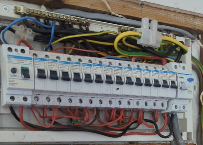

Out of curiosity, are we allowed a photo of the whole board?
Not to have a go at you, as you didn't fit it, but your photo has got me wondering how someone has arranged the tails and internal distribution....
Thanks pc. So in the case of and actual fault/trip there will never be a case of one or the other indication. Sorry, trying to learn ☺️
Ask and you shall receive. Including the world's largest connector block, random upsidedown breakers with bus bar at the top, and holes everywhere. IP00 😂
Wow. That's not just a rats nest, that's dangerous.
It's missing a main switch so there's no single point of isolation, the 6mm carrying the feed to the LH RCD is under-sized for the load and is only protected by the suppliers fuse, the 6mm from the RCD to the bus bar on left is under sized. It also looks like the LH neutral bar is for the right hand circuits. And half the Neutrals for the left hand circuits look to be in a choc block.
In short it's an absolute nightmare, a far cry from a college test rig.
Don't take this the wrong way, but if you haven't yet done much testing I wouldn't make that one your first deep dive testing experience, or your first board change. For context I don't think I've seen one as bad as that this year. I'd be charging a premium to even entertain taking on that!
I know. Will be getting someone to change the board for me don't worry. There is a isolator between meter and board so at least there's that. Thanks again for all the advice.
whats the top side of the breakers look like?
Does the left rccb power the 7 leftmost breakers, and the right do the other 7?
It could be cumulative earth leakage. Everything tests fine on its own... but every little device has a minute earth leakage... if you've got loads plugged in, it'll all add up. And the 30mA marked on RCD's is just an upper limit. It could trip at 19,20, 21... Thats what the ramp test checks for on an rcd tester.
It appears the right hand rccb has been changed already..... is the problem on this side or the other, older rccb?
(or was that where the mainswitch was?)
Basically.... what im trying to say is, you could spend hours, days, trying to find a fault that wont show up.
By all means, do a the testing.... but if its inconclusive, dont waste time going over and over the same thing

Hiya. So the left RCCB (the original one by the looks) does the left most 4 circuits (the lighting circuits. And the new one on the right does the other 10, although 2 are redundant so 8 at present. That's the breaker that's tripped like 20 times, although on 1 occasion the other RCCB tripped also. From everything I have read and all the advice people have been kind enough to give. It does look like it will be cumulative earth leakage on those 8 circuits. But I don't understand is why without the introduction of any new appliances after 2 years of no tripping am I now getting it everyday? That doesn't make a lot of sense. Do USB sockets add to leakage as that is the only thing that has changed in that time. I want to do IR testing anyway as if I'm going to get someone to come and change the board. I want to know from my own benefit that the wiring is sound. What I did think was that if it all checks out on the board change goes ahead. Then at least having individual RCBOs will be able to share the leakage and it may just go away on its own? Thanks for having a look at it for me
Reply to Nuisance RCD Tripping - Diagnosis Advice PLEASE in the Electrical Tools and Products area at ElectriciansForums.net
An RCD keeps tripping. Please see attached photo of the board (2 photos attached). I’ll call the breakers: MCB (1) marked ‘Upstairs lighting’...
