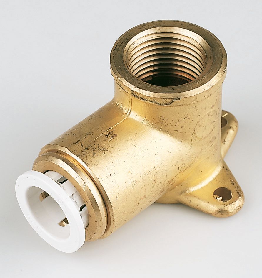

Cant replace that bit unfortunately as it is a hose union backplate like so:
https://www.NoLinkingToThis/p/hose-union-back-plate-15mm/56415
I would love to have a plastic version, but have had a quick search and cannot find
Tricky. You could take the pipe out, 90 deg bind then something like this:
https://www.NoLinkingToThis/p/jg-speedfit-plastic-push-fit-adapting-90-wall-plate-elbow-15mm-x/17692
Not as neat & elegant though.
Or just replace the 1st copper section after it comes through the wall.

Yeah not as neat, its nice being flush to the wall but I see your point
Yes that is a good test, I will try that between tap and next copper section inside. If it is the case there is parallel resistance in the wall, would that be beneficial in a PEN fault (seems crazy brick wall could conduct) although the bricks were put there in a long time ago and they are the breathable kind so iv been told (house was built in 1840)
