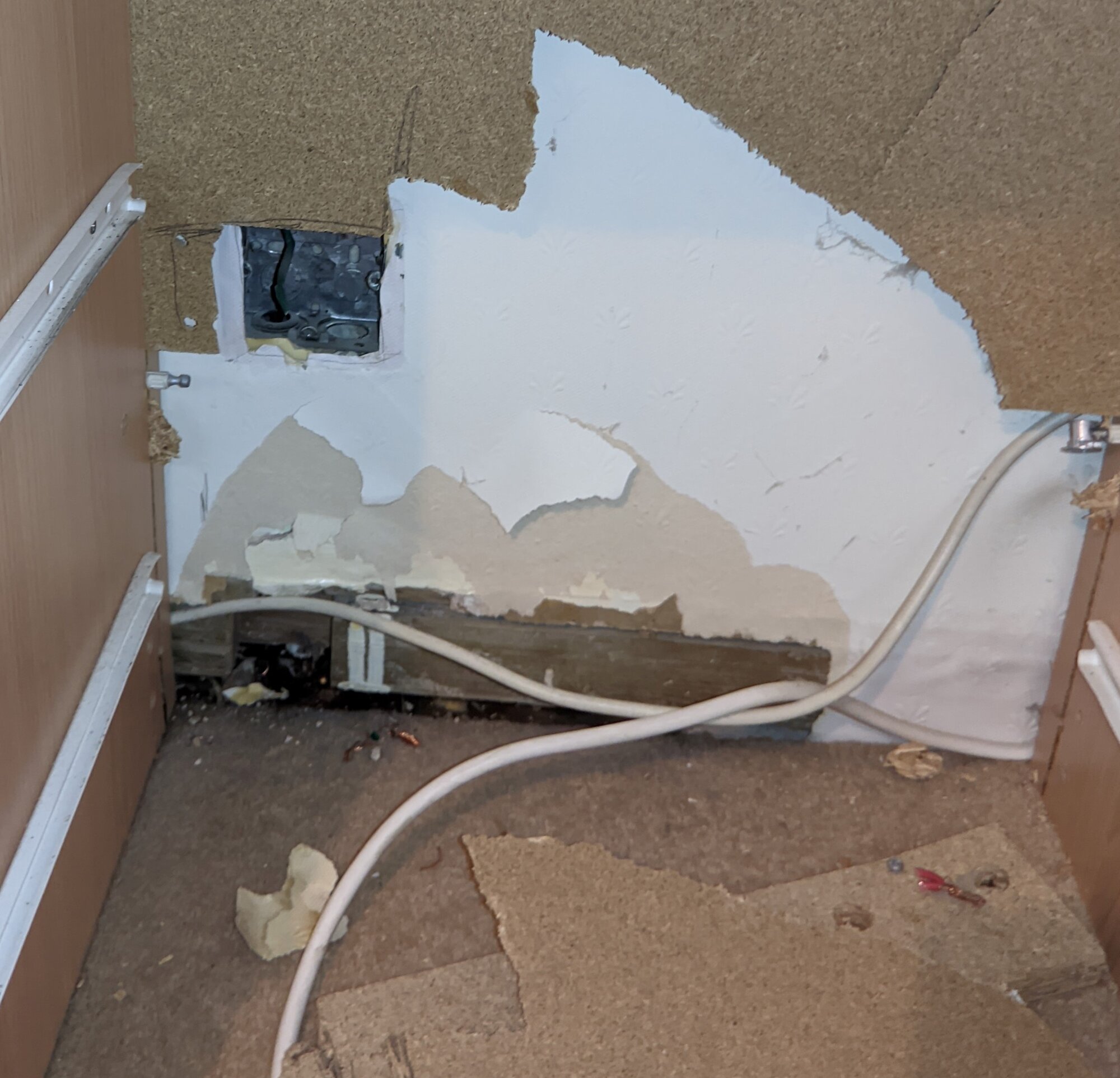

One of the oddest jobs I've ever had today. Called by a plumber I know who had attended after a leak through the kitchen ceiling from bathroom above - and got a shock from the bathroom tap (and his 'pen glowed on everything')
Turned up to check and, sure enough, voltage of 16V AC showing on the (plumbed) towel radiator, the basin tap and the bath taps - but not on other pipework. This disappeared when the socket circuit was isolated.

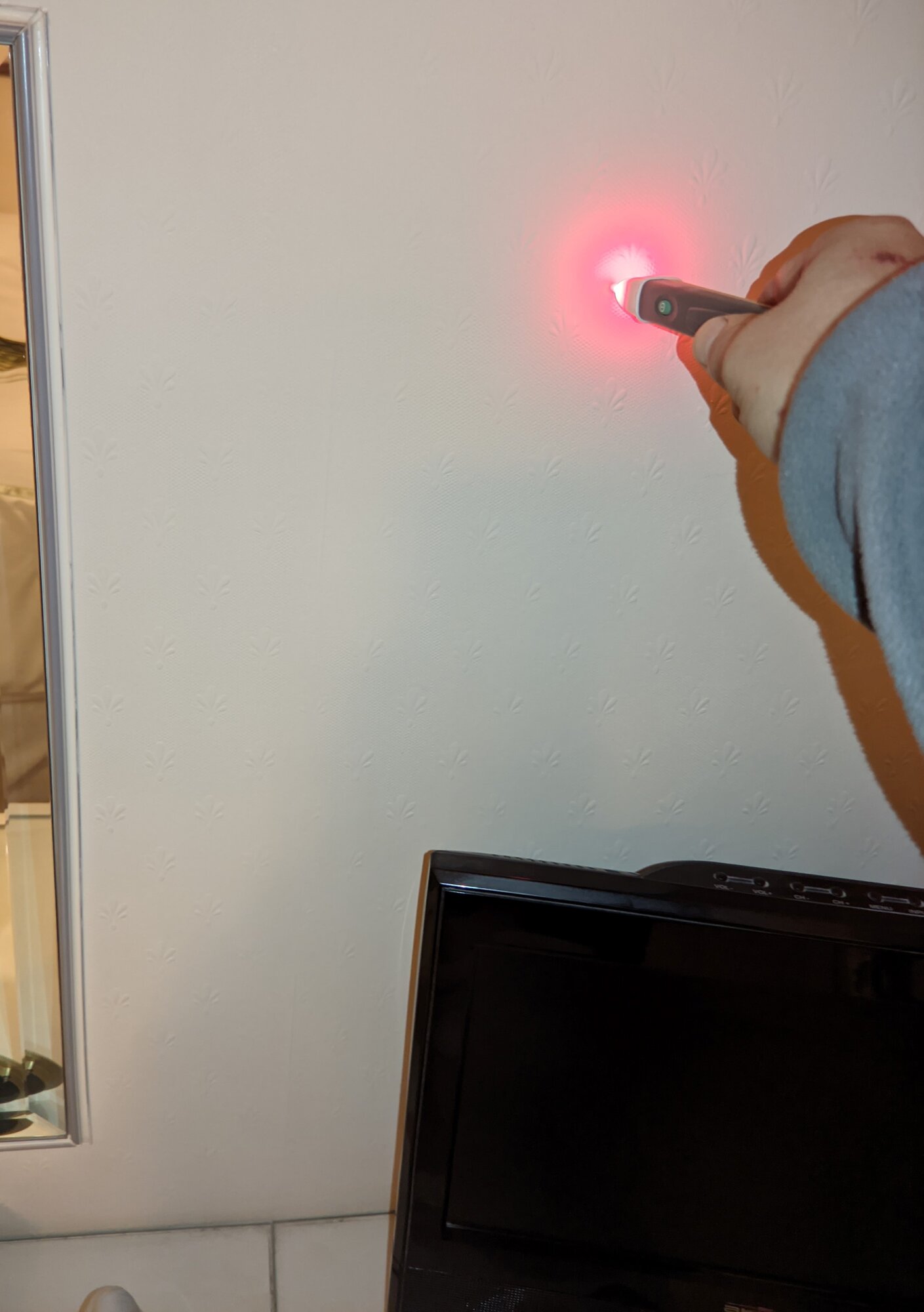

Kewtech pen more or less lit up anywhere in the bathroom, including the walls - and the carpet of the adjacent room!
There was no supplementary bonding in place, and a late 60s metal Wylex board with plug in MCBs, There was gas bonding, but no water bonding - however the incoming water was seemingly in some sort of plastic (Plumber didn't know it's name but has seen it before used in properties of this age)
My first thoughts was that perhaps a junction box was sitting in water...
However the plumber struggled to find any noticeable leak, other than a fairly small but constant run from the shower screen when shower was on...
Lots of head scratching later and discovered the problem, but not one I would have guessed at.
Finally cut a hole in the kitchen ceiling below, to find a damp patch (but not floods of water) right where the cabling ran up in the stud wall to a socket in the adjacent bedroom.
Located the relevant socket in the back of a built in chest of drawers, and the bottom wooden joist of the stud wall was sopping wet. However, the socket itself was bone dry with no sign of water damage. Also no sign of damage to the cable sheath where it ran through the wet wood.
However, it it looks like in some way the flow from the shower had run under the tiles and soaked the joist of the stud wall opposite, enough to allow current to transfer to the heating pipes that also ran through the wall.
This then seemingly transferred to the radiator, and all the other metal fittings in the bathroom.

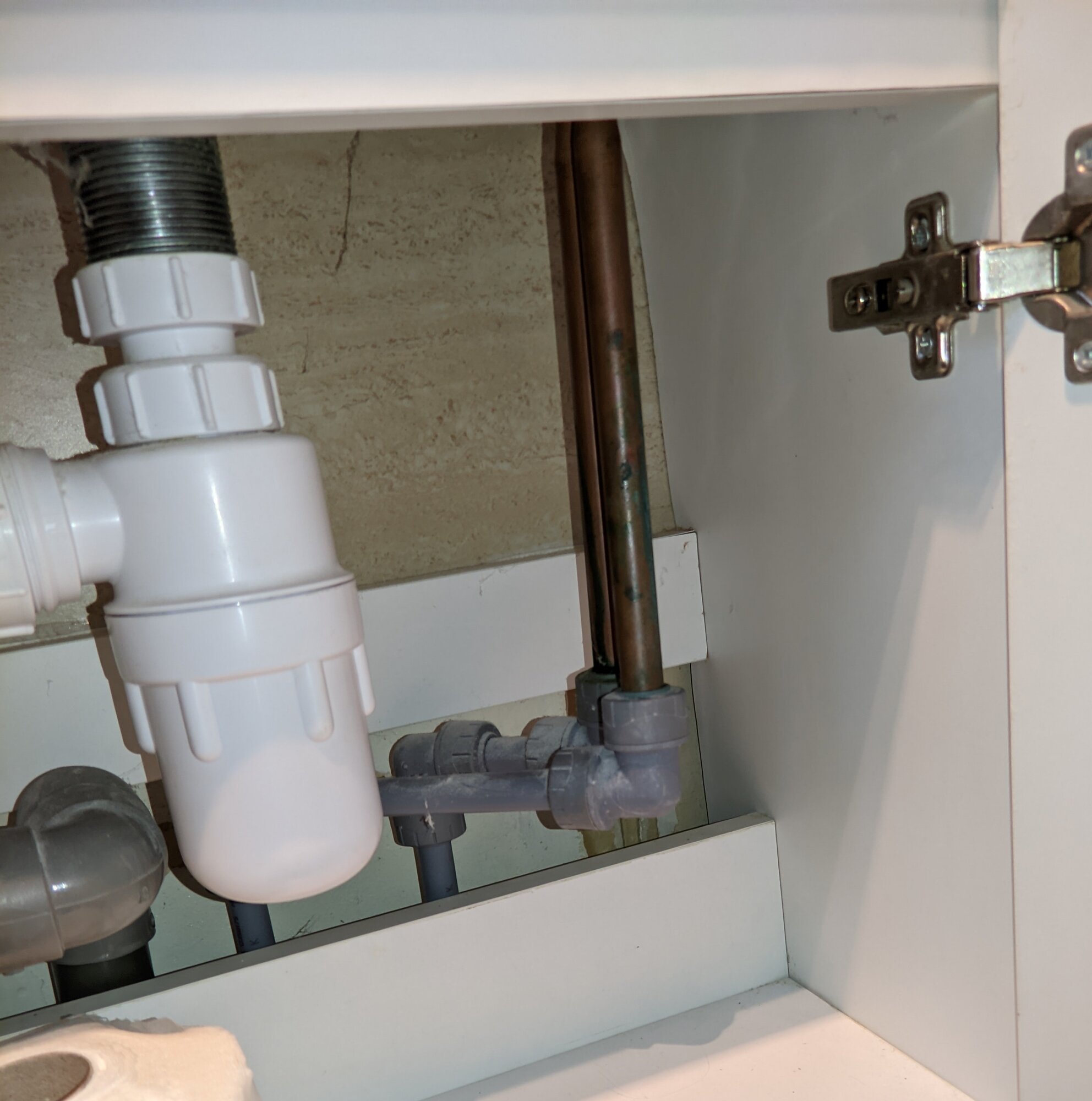

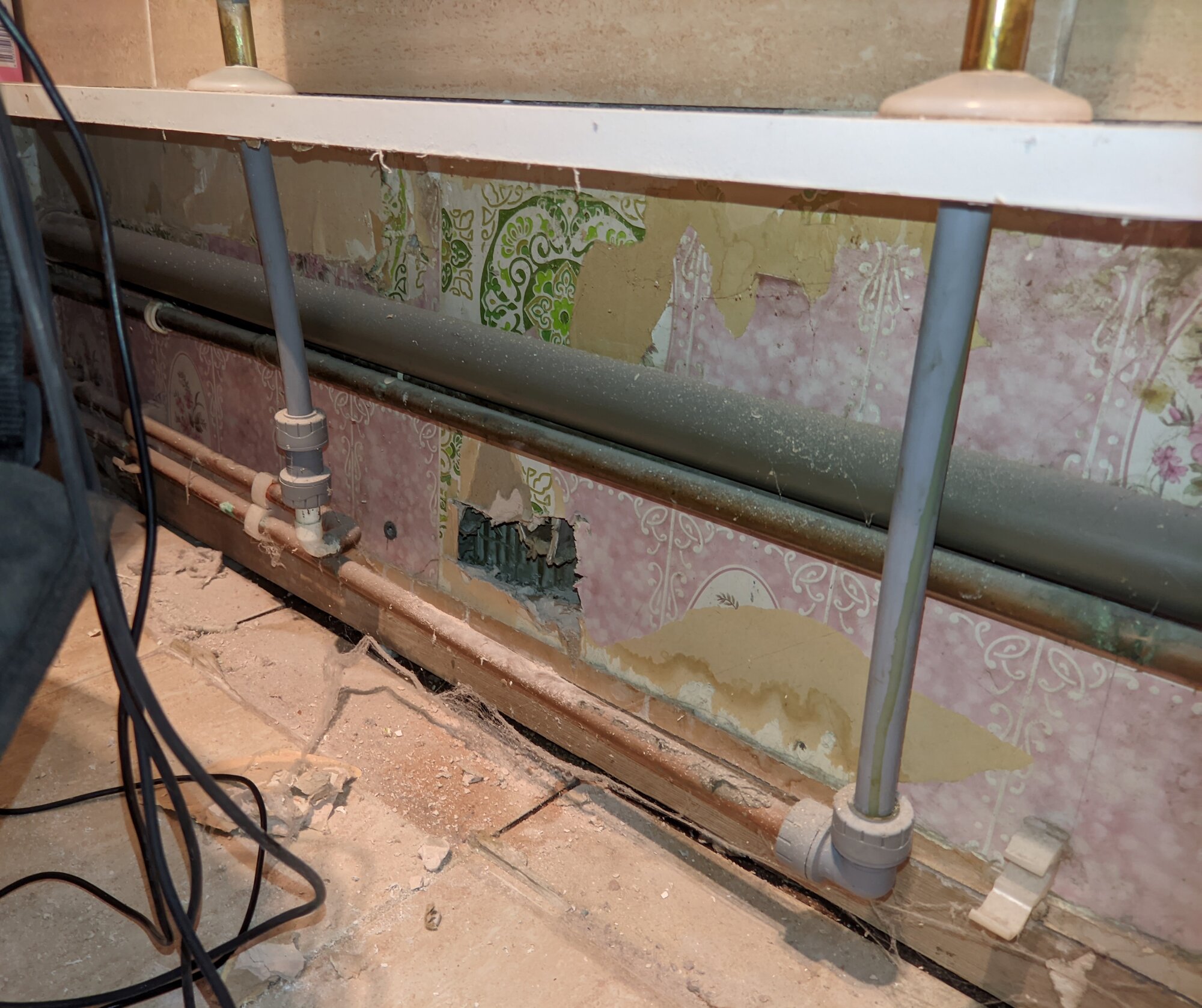

Interestingly, the basin tap and the radiator were both connected with short plastic tails to copper - I can only assume that the water itself was conductive enough to allow enough of a current to give a noticeable reading. Does show that short 'insulating' pieces don't negate the need for bonding.
Pulling the cabling down into the ceiling below and reconnecting it removed the stray voltage so that clearly was the problem. Whether the leak was resolved or not is fortunately down to the plumber!
It was an emergency job with no warning after a long week, so my brain wasn't fully in gear, but it has raised some interesting issues for me...

This is what I found when access hole was cut in the ceiling below:
and this is the socket that was above:
Not obvious from the pic, but the lower part of the wall was sopping wet - and there were 'tide marks' on the wallpaper
Same wall but at about shoulder height:
PVC fittings below towel radiator
and basin:
and basin:
something wrong there. 2 x T/E going up into the wall, but not to that socket back box, which has 1 cable running through it, .
It's good that the voltage has disappeared, but frustrating that you didn't find some electrics drenched in water, but rather a bone dry socket. I can't see how that could still be causing a problem if it was completely dry.
The 2 possibilities are that there is fault somewhere else, or the fault is with that socket and we just can't work out why. Frustrating!

The pen was more just for interest I agree, certainly didn't rely on it for any diagnostics - was amusing to see it light up on the carpet though, (which it turns out was slightly damp underneath but not detectable from above).
