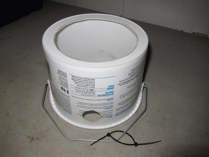

Here's one I made with a dust extraction port for core drilling a 107mm hole from the inside:

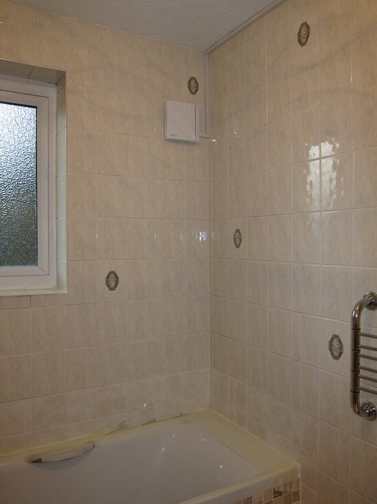

The job was this bathroom extractor fan. I chain drilled the tiles and broke out the middle. Then core drilled from the inside. It was in a nice ground floor rental flat, and the landlord was keen to keep the mess to a minimum, so he held the dust catcher while I drilled.
The masking tape on the bath was to keep the sealant clean and stop the ply board I put over the new bath from scratching it.
By the way, it was surface run as ceiling was concrete and no access from above or via adjacent room.
That's one of my tricks!
I knew I should have got a patent on it! ;)
There's no need to hold it against the wall as long as you have a roll of trusty gaffer tape (the Roadies best friend)
