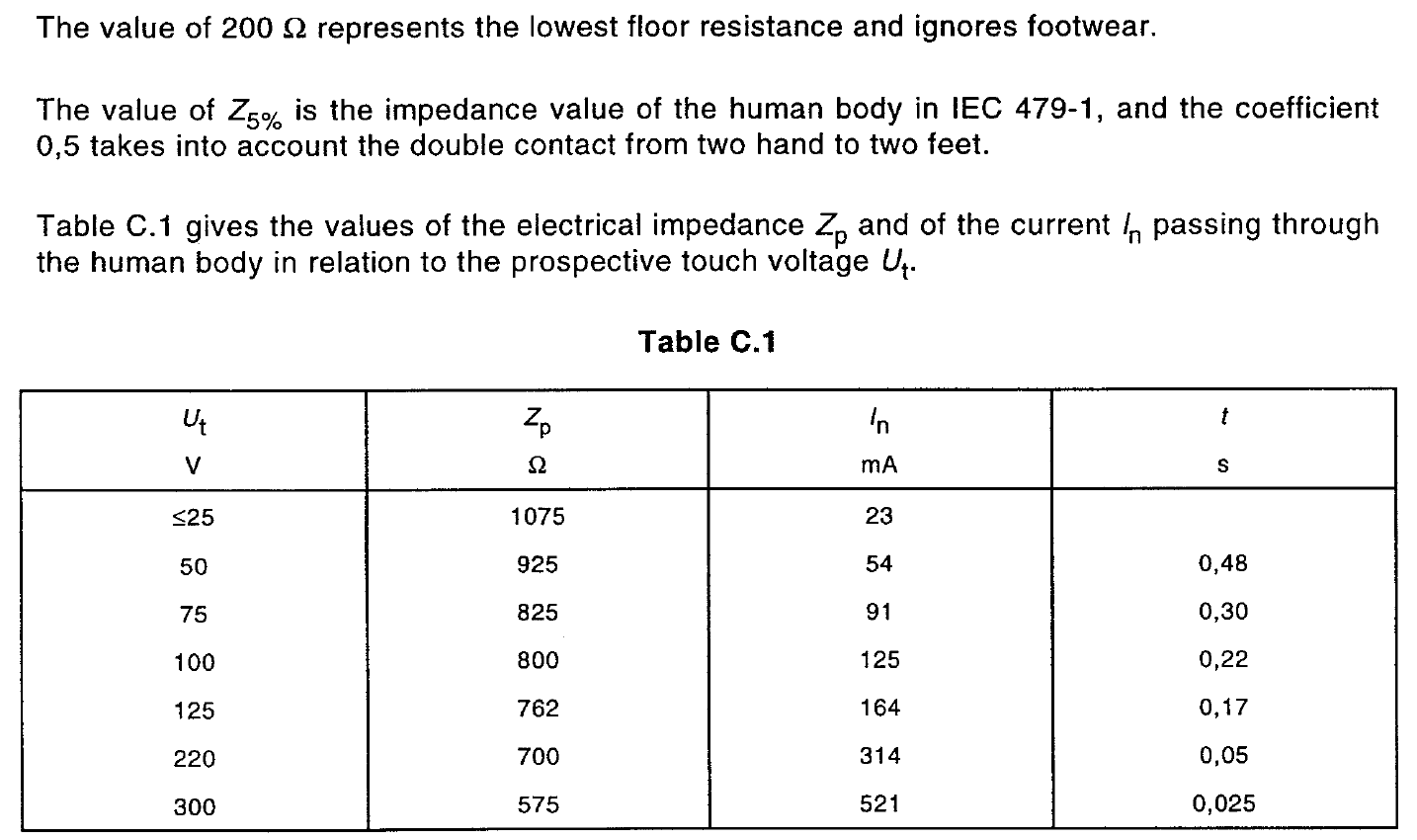

Your original question answers this!
It does on the basis that BS7671 fails to require a faster disconnection time.
IEC61200-413 assumes 200 ohms in wet locations and allows for a maximum of 0.17 seconds.
