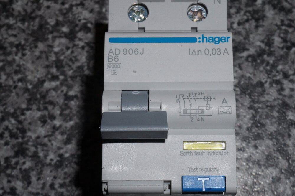

These are double pole switching: Electrical Wholesaler - Hager RCBO 2P(1P+N) 6kA B-40A 30mA A Class AD940J - https://www.electricalwholesaler.ie/products/switchgearfuses/switchgeardistribution/rcboresidualcurrentbreakers/hagerrcdrccb2p40a30maaclassad940j. All the double pole switching units that are definitely double pole are two module wide, all those that say they are and are only one module wide on investigation are not.
