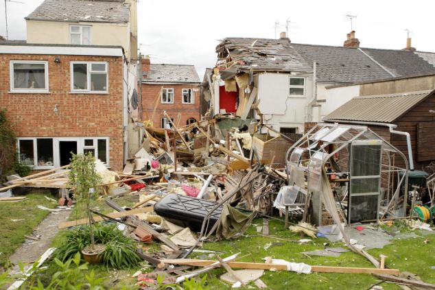

Do you have an inaccessible junction box that needs inspection ?
Let Grittish Bass look after your world !
(No members of the public were harmed in the making of this picture)
That's because,the householder was down the bank,she was dipping in to her life savings to pay Gritish bas for the inspection,
A spokesperson later stated "the junction box just had to be somewhere"
