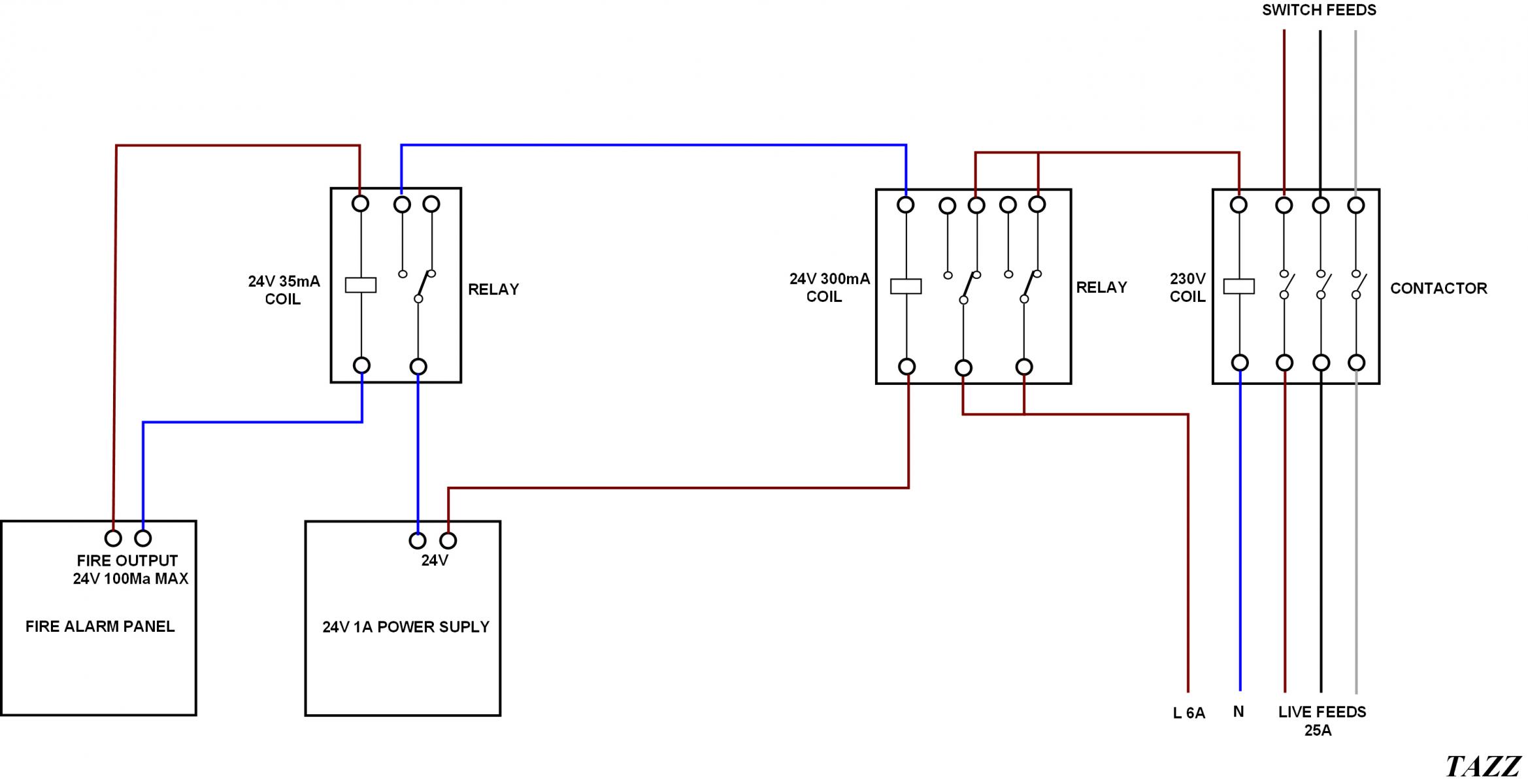

Just thought I would explain the situation, my help when working on Gent panels....The objective was to switch a 24v relay, which inturn switch a 3 phase contactor. On testing the 24v relay it drew 300mA, The Gent fire panel could only switch 100mA on its fire output. Therefore the current limiter kick in, and disconnected the output. Lucky for us, there was a 1A 24v supply installed next to the panel. So on buying a smaller 35mA 24v relay with 10A contacts, the Gent panel was able to power this relay, with inturn switch the 300mA relay via the power supply...This final relay, with mains rated contacts, then power the contactor.

Thats great tazz, thanks again for sorting this out for us! Diagram is really clear, i liked the way you paralelled the two contacts in the 300ma relay so if one set of contacts fails the other one will keep it going (top tip for the future)
35ma relay from Maplins was the best £1.90 ive spent in a long time, also lucky to get there 5mins before it shut on saturday!
Your diagram also makes the small 5 pin relay pin configuration easy to understand as i was a litlle unsure as i havent used any small ones like that before with no carrier/base, i know you belled it out but did it have a drawing on it as well?
