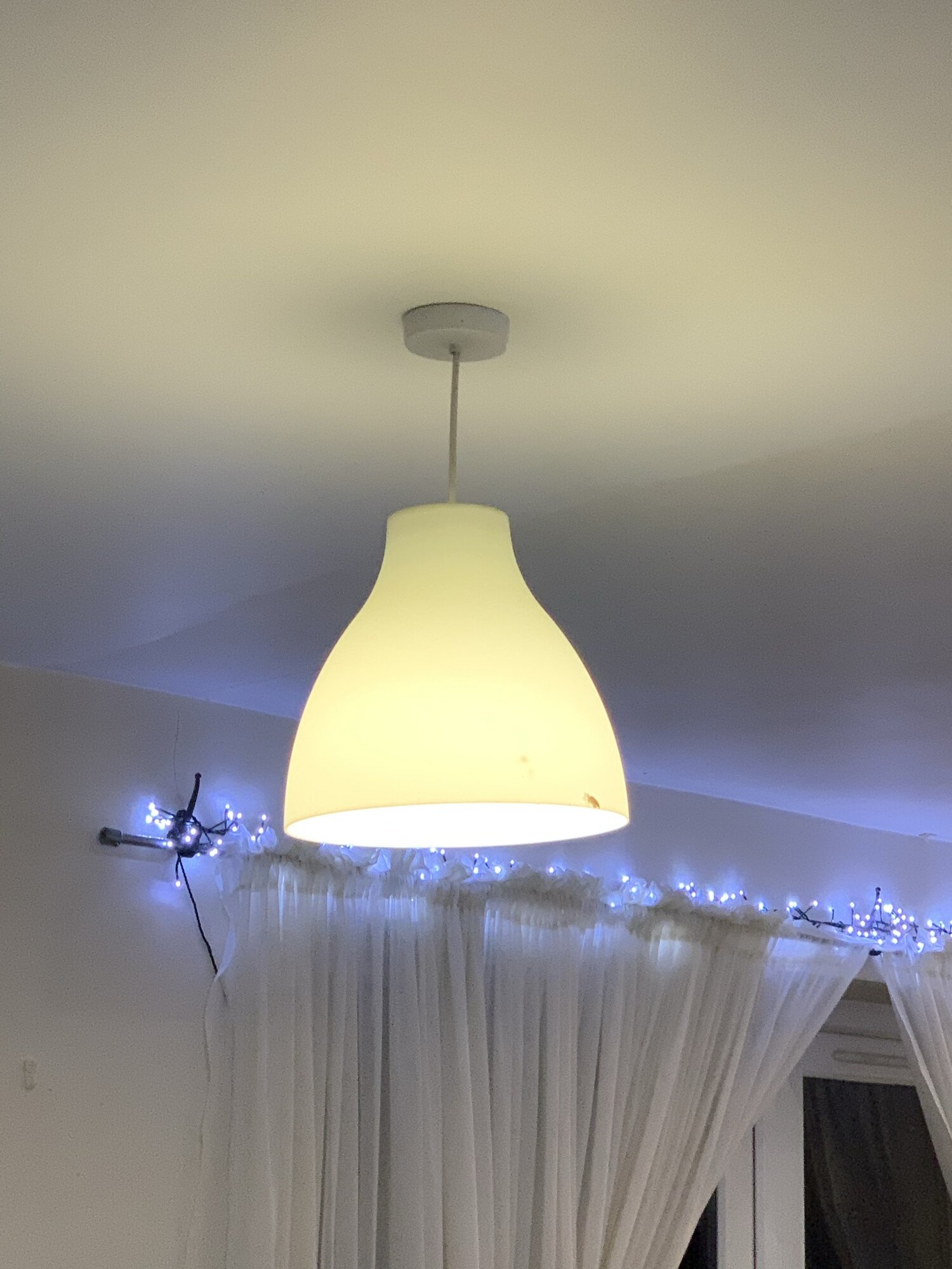

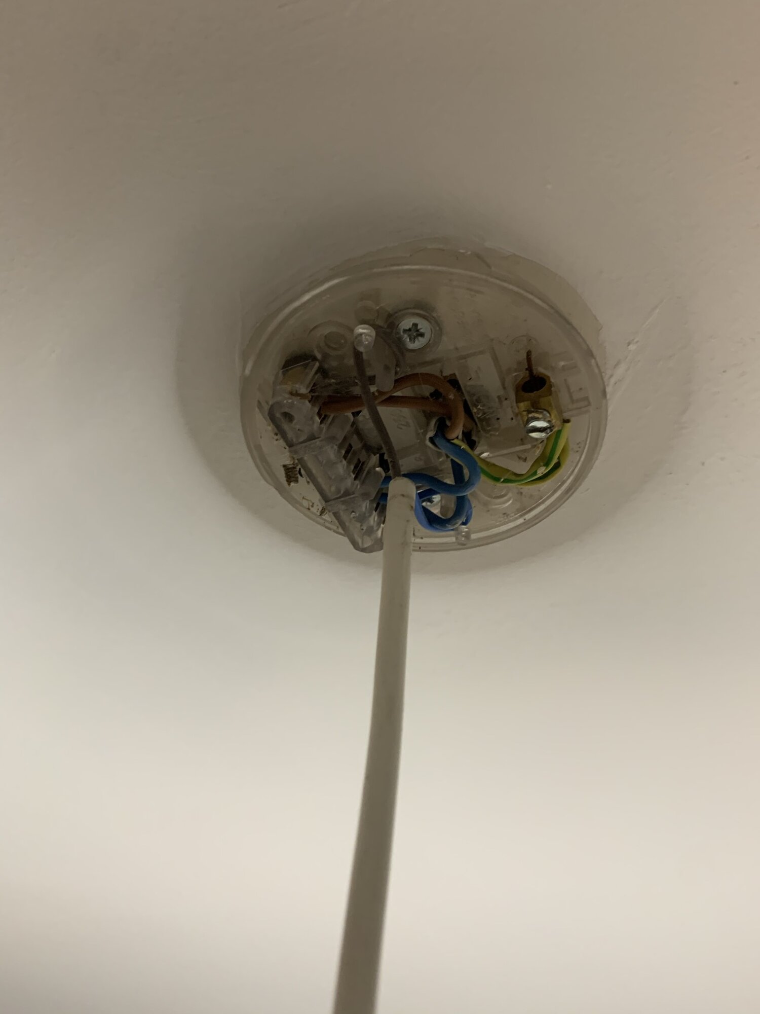

I have two 'regular' lights in the ceiling and I want to change them to spot light fixtures. (images attached). I cant fit the mounting plate over the plate that is already on the ceiling that is housing some cables (I assume because there are two lights on the circuit). So how to I go about keeping these cables in tact and fitting the new light in this space? IMG_5324.JPEGIMG_5322.JPEGIMG_5321.JPEGIMG_5323.JPEG
Thank you in advance for any help. It really is appreciated.

I agree. The three out and in is not the issue, its the cables that are in the fixing plate already that will need to stay in there or something else to keep them in the same setup as I dont think I can mount the new light over this existing plate in the ceiling?
The cables will have to be disconnected and the pendant base removed before fitting the new light. The new light won’t and can’t fit over the existing.
Thank you, this is what I thought. The cables in the pendant base already can just be secured into new terminal blocks that then hang loose inside the new light fitting?
You need to remove the existing fixture and bin it, and then need to wire in the new light using the correct wires in the correct connections inside. The light, by the looks of it, will need to be fitted by fixing that metal bar to the ceiling and then screwing the fixture to that. Hard to see from the angle of the new light fitting but i reckon that's it.
You can't fit your new fixture right over the top of the existing ceiling rose. If in doubt, get someone out - it would only cost you a call out as it's a 10 minute job. Should cost no more than about 65 quid, if someone does it and is already in the area they might do it for a drink.

Why would that need to be done? There is ample room in the base of the new light fitting for the cables. Plus most likely there will be a ground behind the plaster board so not much hope of getting a JB up there.

I certainly wouldn't knock a hole in the ceiling to fit a joint box, as per @123 they can easily be jointed in the lamp base.
When he says there is a 'ground' there, I suspect he means 'joist' and it has auto corrected.
As per westy and 123, plenty of room in the fitting for the connections, no need to make a big hole in the ceiling. Plus that may make fitting the bracket tricky if there's no flat surface left.
