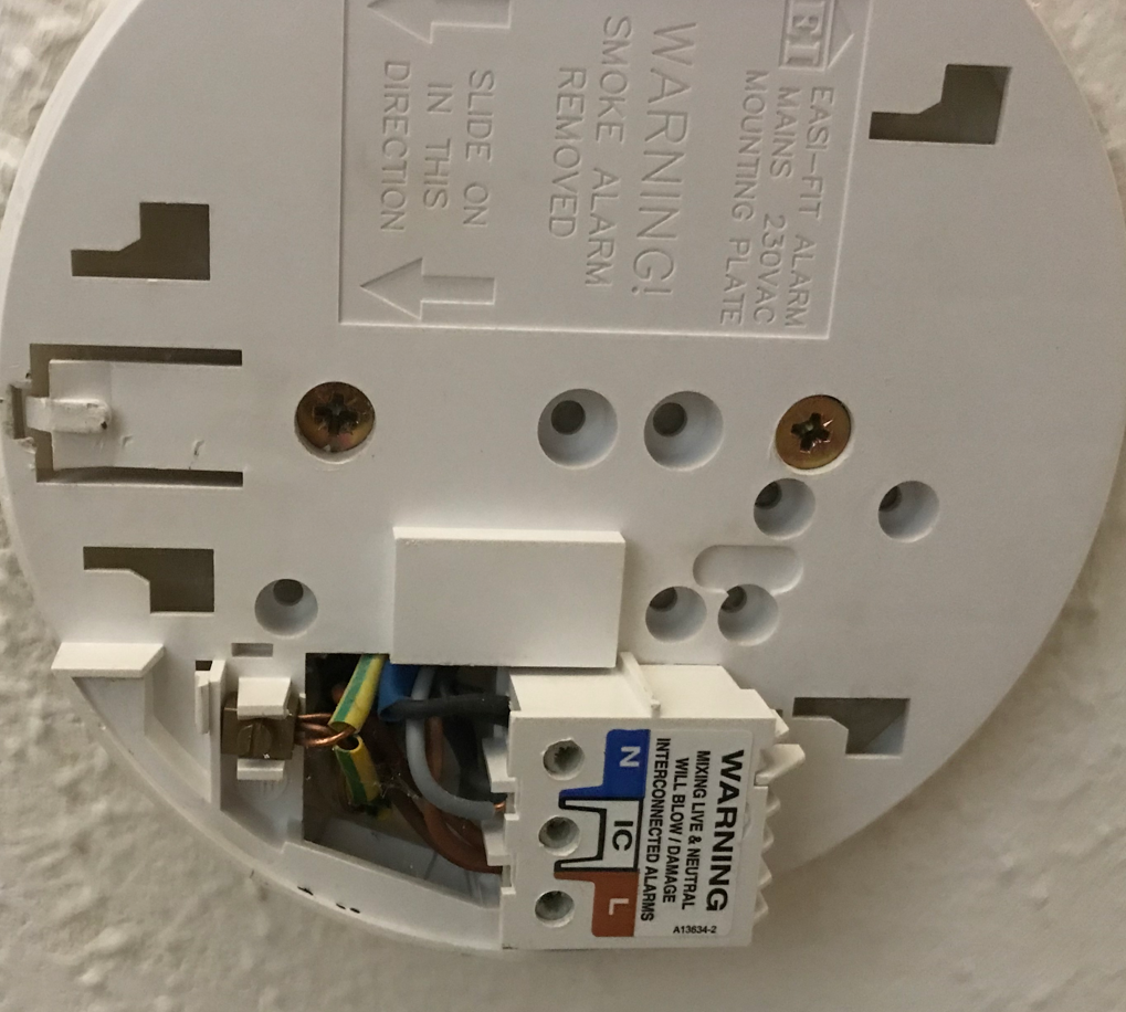

So all detectors now have the green indicator illuminated.
Reactions: Neptune
Yes, apart from the two faulty heads. These heads don’t work on other bases and the working heads work on these two bases too.
All the bases now have mains power. I verified that.
Hope that makes sense…
Without a continuity tester to eliminate open interconnections it is difficult to pinpoint the problem.
Rather than a continuity problem, it's more likely to be that the interconnect wire is shorted out, either by a wiring fault or a faulty detector.
I was about to suggest is it being tried with the faulty detectors not in place.
Test each alarm in turn, if two sound then they are interconnected, then do the same with one of those and the next one, when you get to one that does not sound with the previously sounding others then the interconnect between it and the others is suspect, this way you could narrow it down to one of two legs, test between each cable at the alarm for shorting, a continuity tester and a long lead would make it easier between alarms.
Another but messy check is to temporarily disconnect each alarm from the existing interconnect cable and then connect each alarm with some 0.75 multi stand, cheap and easily obtainable.
Or disconnect the interconnect from all the alarms and put in the radio base's probably easier in the long run.

When I tested these earlier today, I removed all the heads and then fitted the first one (where the mains power was supplied). I then fitted what I think is the next one in the chain. I then tested, they only beeped individually. I then added the next one and tested as I went along. Each time, there were no multiple alarms beeping.
My confusion: even if some of the inter links are broken, surely not all of them are and therefore some (and probably most) alarms should have worked - I felt.
In my case, none of them have the interlink working. I can do continuity tests across the interlink wire but it just feels that there is something more fundamental as none of the interlinks are working.
Am I missing something?
Also, forgot to mention that there is a call point installed on this system too. I didn’t check the wiring for this.

Is there power at each base?
Is there two x 3 cores at each base?
I’m thinking, if you test at various bases, and there’s no interlinking… maybe there’s a central jointbox and the interlink cable is loose?
I see the first photo they used the wrong colour for the neutral (no discussion… it’s just wrong!?)
Is that the same all the way through?
Neutral and interlink mixed up can cause damage.

Every base has 2 sets of 3 core and earth apart from two:
  • The first one has 1 3 core and earth and another twin and earth (mains power)
  • another base has 3 sets of 3 core and earth. That’s because I spurred an additional detector off this one a few years ago.
If you an get three x 3&E cable connected and fully enclosed within the terminal box of an Aico smoke alarm base, then you have my respect!
They are horribly fiddly aren't they!
