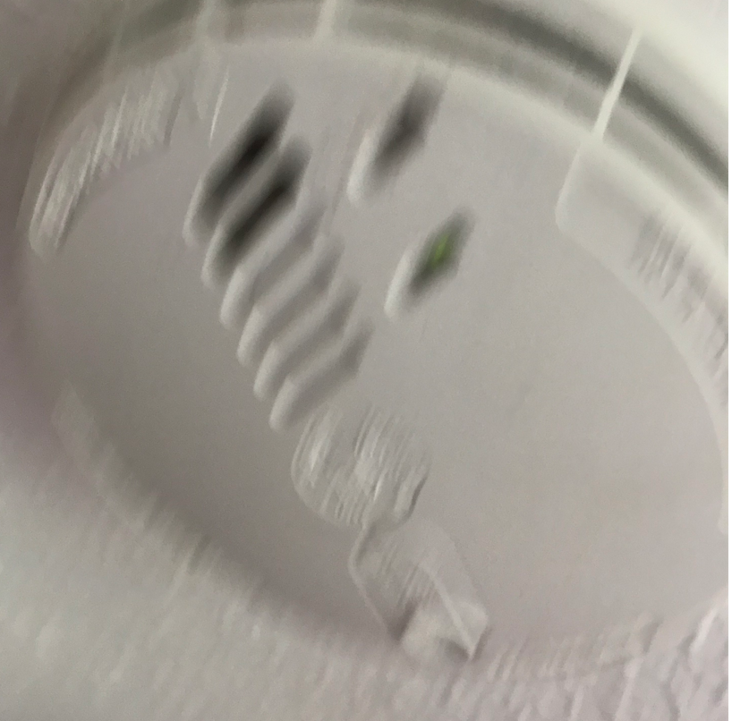

UPDATE: I finally got around to taking a look at this today and wanted to share my finings and plead for further help please.
  • Firstly, none of them had the green or red light on display
  • Some of the detectors beeped upon using the test button and some did not. None of them caused other alarms to beep at the same time.
  • I then removed the heads and started testing across live and neutral using my 2 pole tester. None of them had mains power
  • I noticed that all of them had 2 sets of 3 core and earth cables - except one which had 3 sets of 3 core and earth and another alarm that had 1 set of 3 core and earth and 1 set of 2 core and earth.
  • That last detector was the power supply and again, had no power when tested with the 2 pole tester
  • I then traced this cable in the loft and quickly found a Fused Spur that was switched off! I have now marked this appropriately
  • Once this was switched on, all base units had power
  • I slid the heads back in and they all had the green light apart from two
  • these two heads were unlit when tested in other bases too. I concluded that they were faulty and needed replacing
However, none of the alarms are causing any of the others to beep. I tested each one individually and held down the test button for over 10 seconds. Only that alarm beeped. They've all got an interconnect cable and the same colour is being use throughout and this system was working when first installed a few years ago.

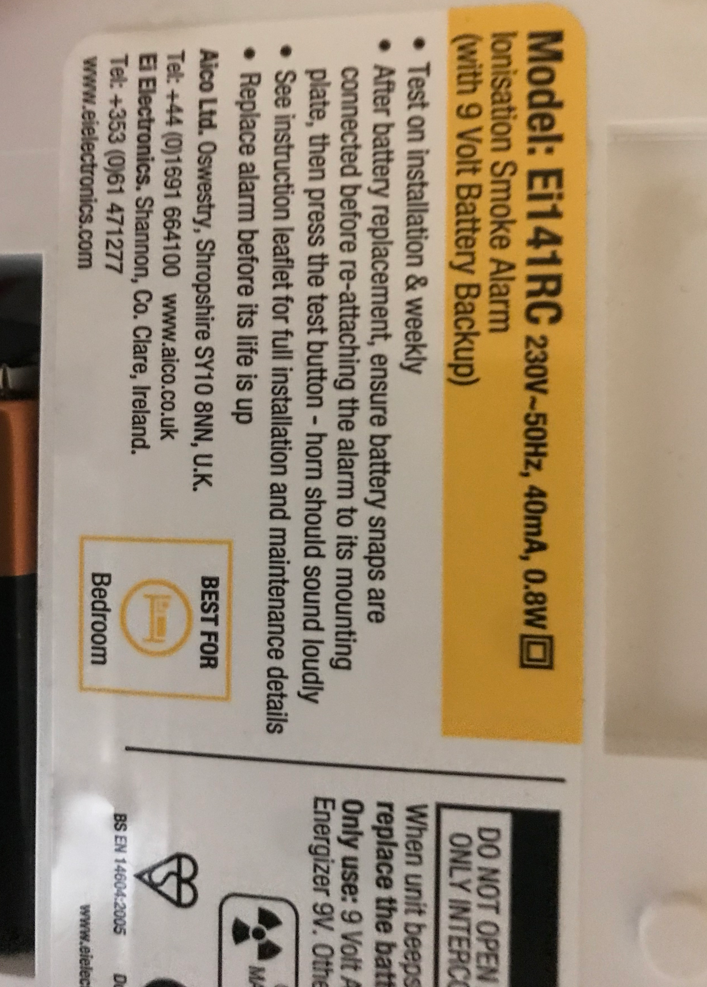

All the heads are Ei141rc apart from the kitchen heat sensor. This is EI144RC.
1 of the EI141RC has this sticker and if I recall correctly was installed more recently. Still the same model as the others?

You need to carry out some continuity tests to verify all conductors.
Reactions: suffolkspark
From the manual available here: Ei144RC Instructions - Aico - https://www.aico.co.uk/downloads/ei144rc-instructions/
"Interconnected Alarms only - Test the first unit by pressing the button for 10 seconds. All the units should alarm within 10 seconds of the first horn sounding. The red light on the first unit only will flash about once a second. On releasing the button the local Alarm will stop sounding immediately and the remote Alarms will stop sounding approximately 3 seconds later (if testing using RF interconnection this could take slightly longer). This will verify that the interconnect is working. Check all the other units similarly."
If this does not work then suspect continuity issues with the interconnect as suggested above.
Reactions: DPG and nicebutdim
Can you elaborate on this please. Not a trade leccy!
Do you mean continuity on the interconnect cable? Even if a few of the links were broken (which I have no reason to believe) I expected the remaining devices to work in tandem. It would be very unlikely that all of them have broken interconnects?
