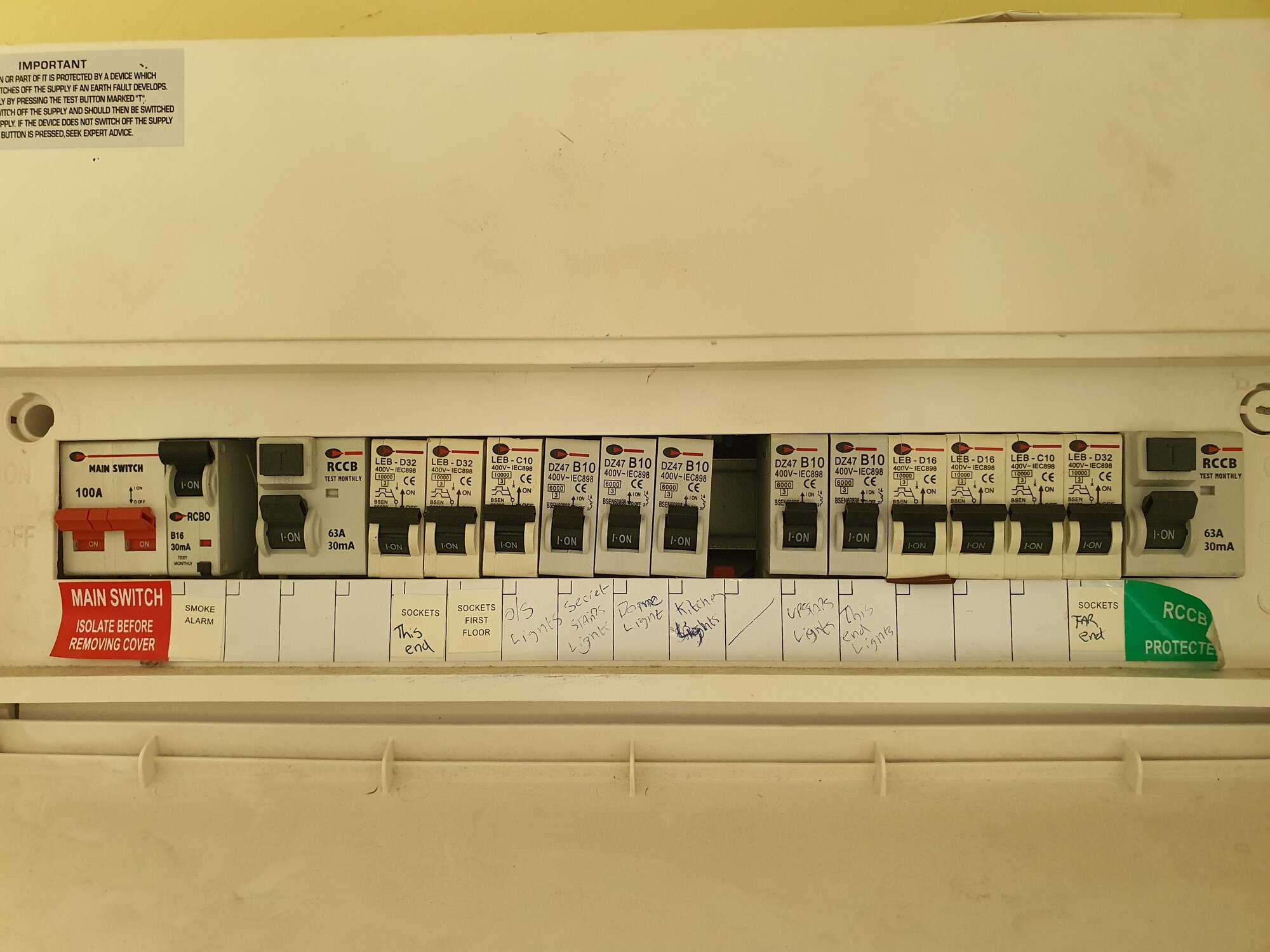

OP states RCBO protection. Perhaps an image of CU might help.
Curious to know which hole caused the initial trip and which hole caused sparking.
Looks like only one RCBO in fact and not part of circuit in question. I think most of you will enjoy a good laugh not only at the state of the CU but the labelling! It was the top right hole that caused initial trip, then the middle hole that caused the spark.

If something tripped when the 1st hole was drilled, but then you still got a spark when the 2nd hole was drilled then maybe you have drilled through two separate circuits? Or did you reset the tripped device after the 1st incident?
Loving the protection devices in the CU by the way. And the secret light!
