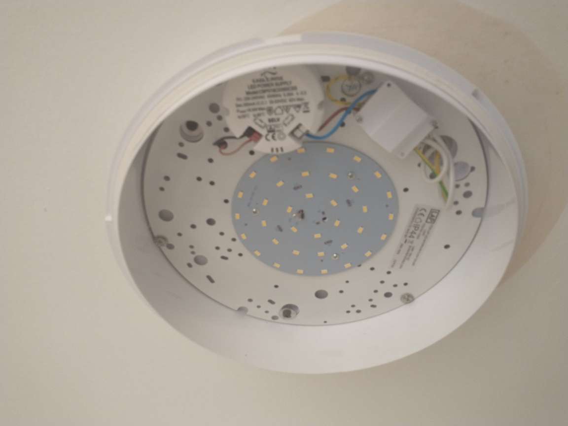

(ii) Is the internal wiring of the LED itself correct? You asked for a photo of the inside of the light and I will do this when I get a moment (hopefully today). I have the VED screwdrivers ready to go!

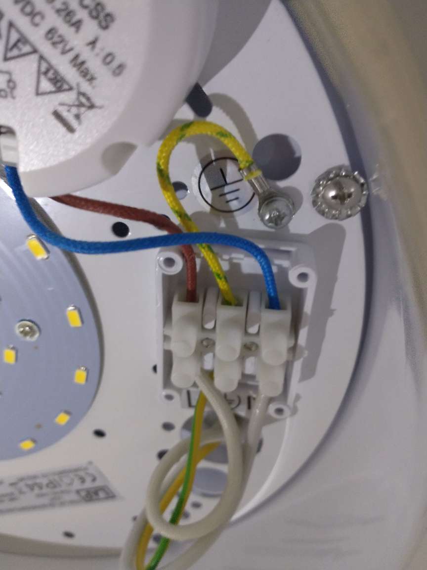

If you feel confident and only if you do please turn off the main switches on your consumer unit and all the circuit breakers. Then take the cover off the lamp and then take the lid off the white terminal box I have pointed to with green arrows. Take a photo of the terminal block inside and post it.
I've checked inside the chocolate box, I think it looks like the wires are correctly connected (especially the earth!) Photos attached as requested. Thanks!! :)
Oh well… the light fitting has been connected properly. It did look like there was a swapped over conductor from the earlier pictures when it still had the lid on the connector.
Make sure you put that lid back on
There's something a bit odd about that set up. Live and neutral come from one direction, cable sheath barely entering the fitting, and the cpc comes from a different direction.
I think L, N and E all come in through the grommet at the bottom side of the connector block don't they?
Now I would take the fitting down and examine the wiring underneath.
Jimster99 - if you feel confident first turn off both red main switches and all the circuit breakers and then remove the fitting securing screws while taking the weight of the fitting. Then take a photo of what you see of the wiring above the fitting especially of any connectors. Then carefully put everything back in place, turn on mains switches and the circuit breakers.
