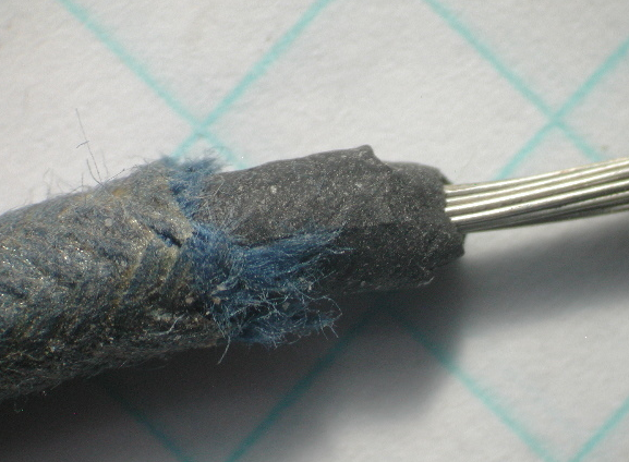

We are currently renovating an old house after recently moving in. Whilst purchasing the property we received written assurances that the original 1920/30s wiring had been fully upgraded and subsequently tested.
After removing all of the downstairs ceilings, it is clear than new electric 2.5m2 and 1.5m2 cable/wiring has been installed, however there would appear to be an old and rather thick set brown fabric cable routing upstairs. Using a ‘non touch’ volt tester I was able to identify that the cable was live and part of the house light circuit. (The full house is on a single ring light circuit is, not ideal but it works). I noticed that this old cable routes into a round, brown junction box with the lid missing. The cable would seem to be an old 2 core cable with no earth present. Both cores are large ‘silver’ cables with several strands twisted together. I’m no electrician and therefore will refrain from touching it or proding around, however I would be grateful if someone would kindly advise if this cable should be changed, or indeed what it is. Everything works as it should, I’m just concerned that if we install new ceilings and it then needs to be replaced. The house is an old property and uses a TT system setup which I believe was upgraded with the installation of the EV charging unit. Any advice would be very much appreciated.

Best course of action is get it replaced now, to ensure there is an earth present… done by a professional so you get the test certificates.

That looks like a bit of VIR which is in surprisingly good condition if it is. As far as I know it shouldn't ever have been installed outside of conduit if it is VIR as its the equivalent of modern singles.
A non-contact voltage detector does not prove that it is live, it shows that it might be live. Likewise they do not prove that something is dead, they prove that it might be dead.
A disconnected cable sat next to a live cable will often cause a non-contact voltage detector to light up due to the capacitive coupling effect.

To be honest I tend to agree with you. I’ve traced the cable from the consumer unit right up to the loft. From there it feed into a junction box. Each wire from the junction box there after is subsequently 1.5m2 twin & Earth. What’s the point of the subsequent wire having an earth when the main feed doesn’t…it just makes no sense to me. I suspect the electrician who rewired the house found it too much trouble to re-routes a new main feed wire from the CU up into the loft for the lighting circuit. He then replaced the more accessible/visible wire. The out of sight mentally I guess - how sad! Hey ho. The rewiring was done in 2006. I completely agree however, the best thing to do is call an electrician to look at and ensure it is safe to use. as when I’ve traced the cable I found a junction box extending said wire. The condition mortified me. Can a professional electrician explain how this wast picked up on a test. I’ve attached a picture below.

This is a picture of what I discovered.
That's not regular VIR then, that's something I've not seen before. It appears to be a coaxial 2 core cable with cotton tape and rubber insulation and a woven sheath.
@Lucien Nunes may be able to shed some light on what it is.
So to answer your question of how the cores are identified it is their physical position within the cable, the centre core will most like be live and the outer conductor neutral (may have been neutral/earth combined originally)

It reminds me a little bit of this photo, described on a USA wiki as "fabric- and rubber-insulated multi-strand electrical wire."
I'm not 100% sure it's the same though.
While it would be interesting to know what it is, whatever it is it pretty clearly shouldn't be in service.
At a minimum the CU end of this needs a good look at, some tests need doing at the junction box you found, and the lighting circuit downstream of it needs testing for the presence of a CPC and absence of any other supply.
Quite aside from any issues from the elderly cable, if there are any metal lights or switches then there is a pressing safety issue if the lighting circuit isn't earthed. It might be that the subsequent T+E has an earth connection from another circuit. (This is permitted by the regs if sized correctly)
