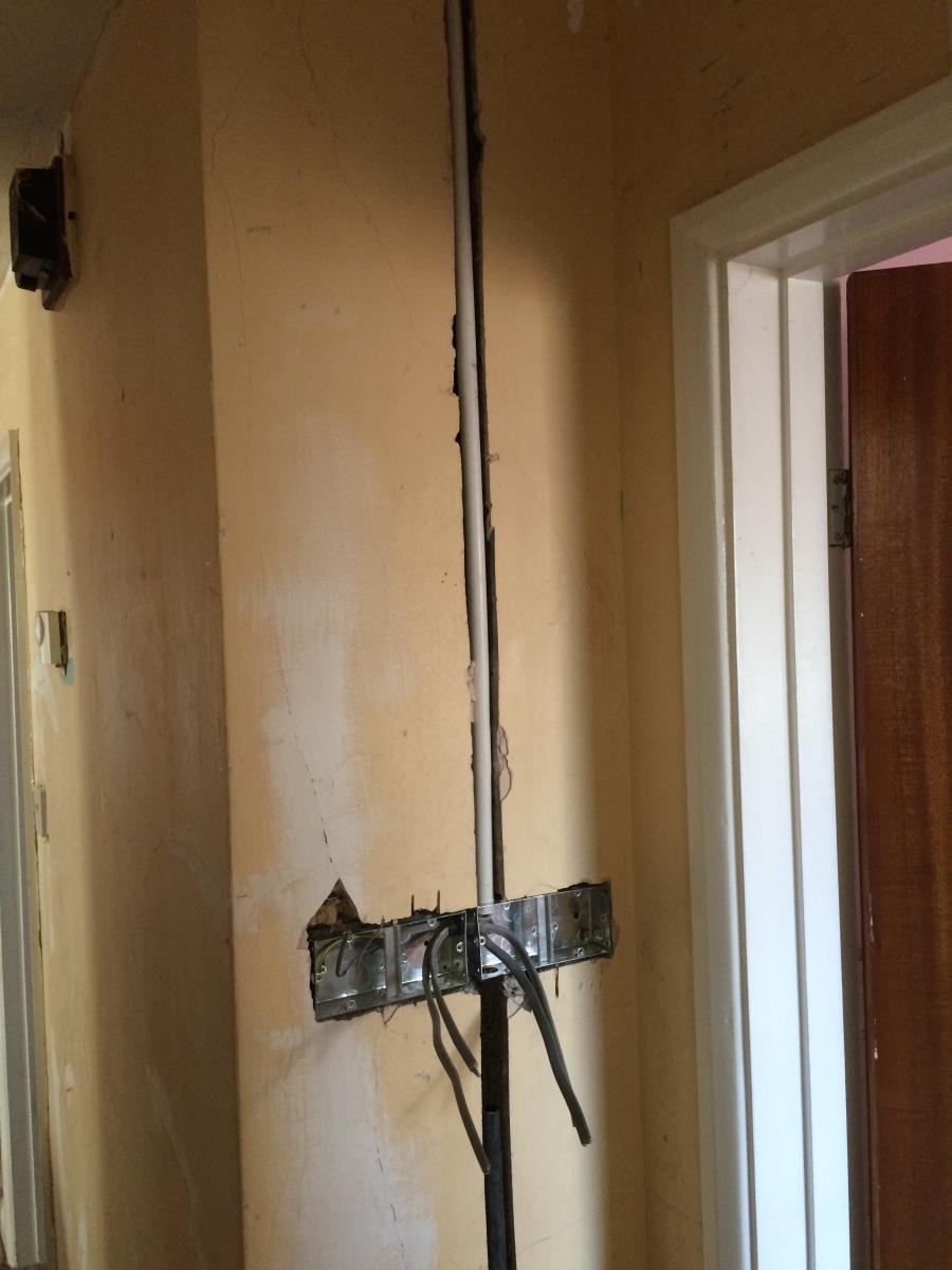

is that the faint reflection of white pvc capping beneath that plaster coat ?
if it is , i suggest you exit now before i rip the --- out of this thread.........
yes, it is, biff. the plaster is very thin in places and the bricks have destroyed 2 diamond angle grinder blades. the walls are being papered anyway. so rip away.
What's the problem with plastic capping ?
Personally I'd use oval conduit in chases as they only have to be half as wide then
have used tube where possible, but in some places the plaster is so thin that the clips would have been proud.

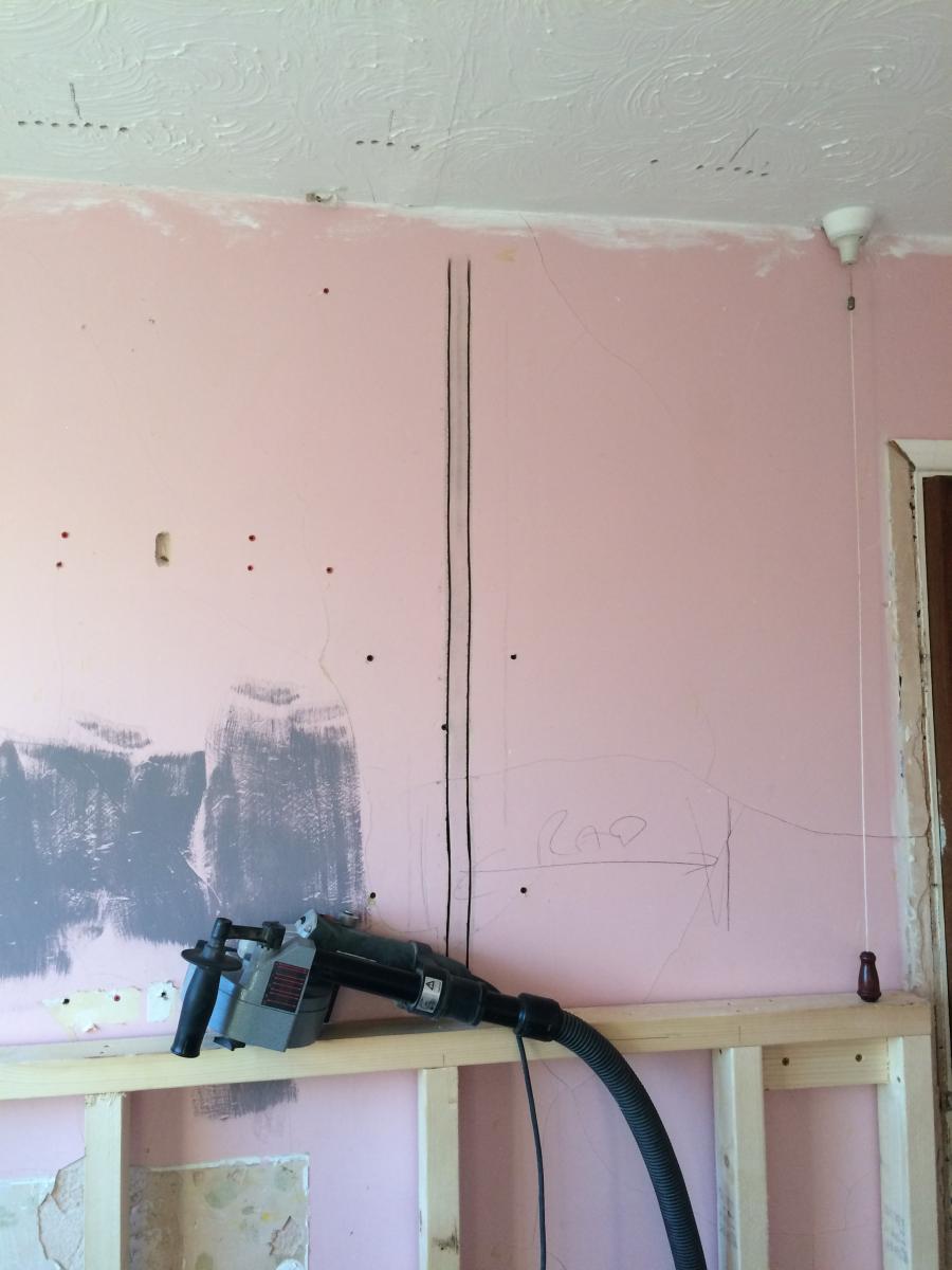

I use a metabo chasing machine that cuts a chase 25mm wide and 25 mm deep , then remove the middle with a chisel in the multi drill , then install cables in 20mm round conduit with conduit just into the 20mm holes in metal boxes , plaster with one coat plaster and reskim and smooth of with trowel and water spray , , this leaves the conduit 5mm below surface , when I'm finished its ready for decoration ...
I find that anything less than 5mm may cause the plaster to crack if too thin in the future..

I do this in any house , I also attach a henry vac to the spout on the chase , the dust you get is when using the multi drill , but then you would get that anyway , still its a lot easier and cleaner than other ways I have tried , The chase machine has a spring loaded hood that sits flat on the wall so forms a good seal for the vacuum to work so its really clean . along with dust sheets as normal of course ...
I am doing a job at the moment so will post some pics later next week..

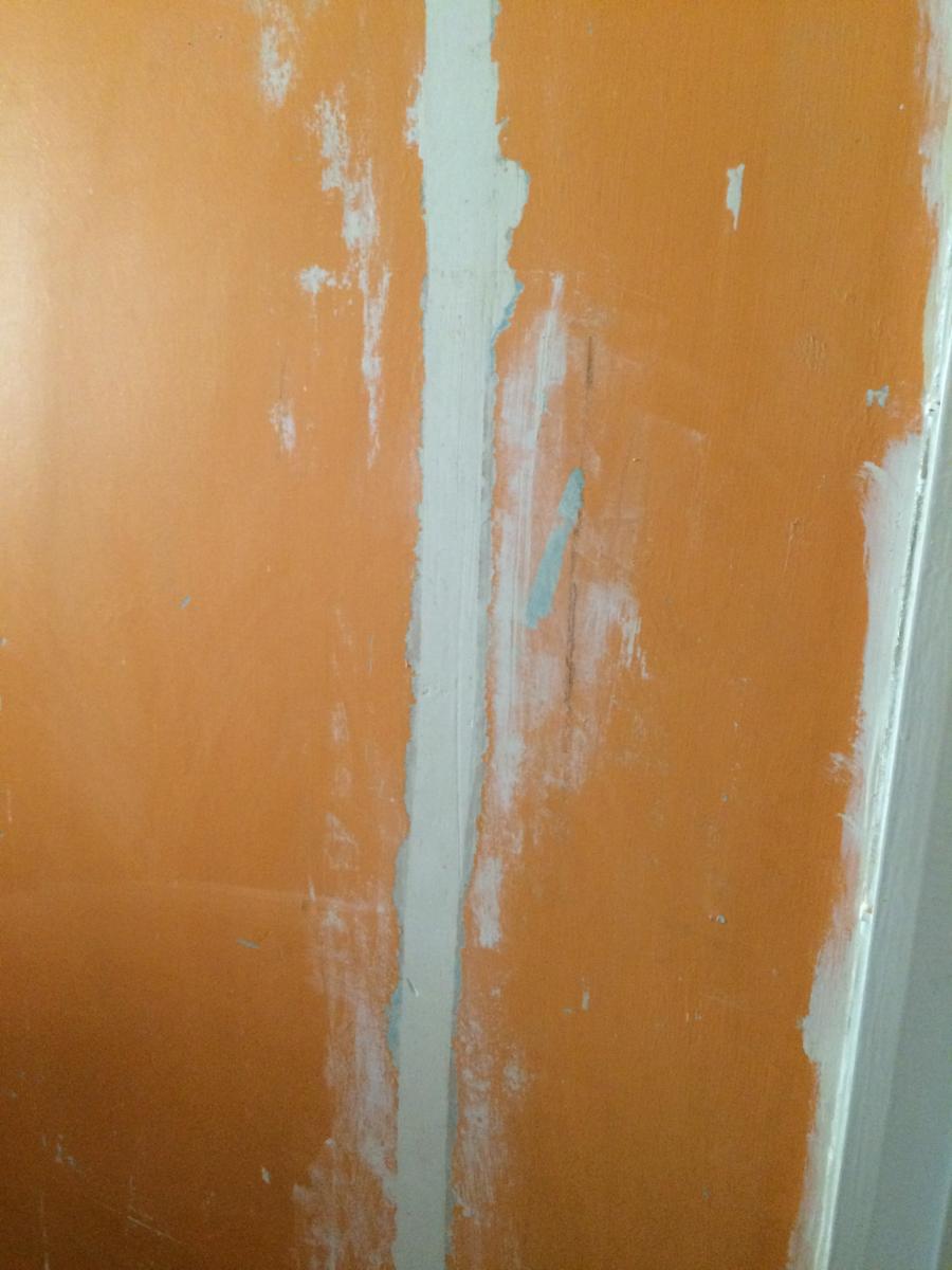

IMG_0155.jpgIMG_0152.jpgIMG_0156.jpgPhotos as promised
