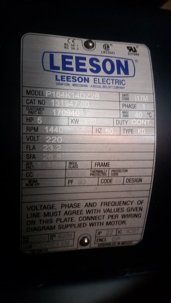

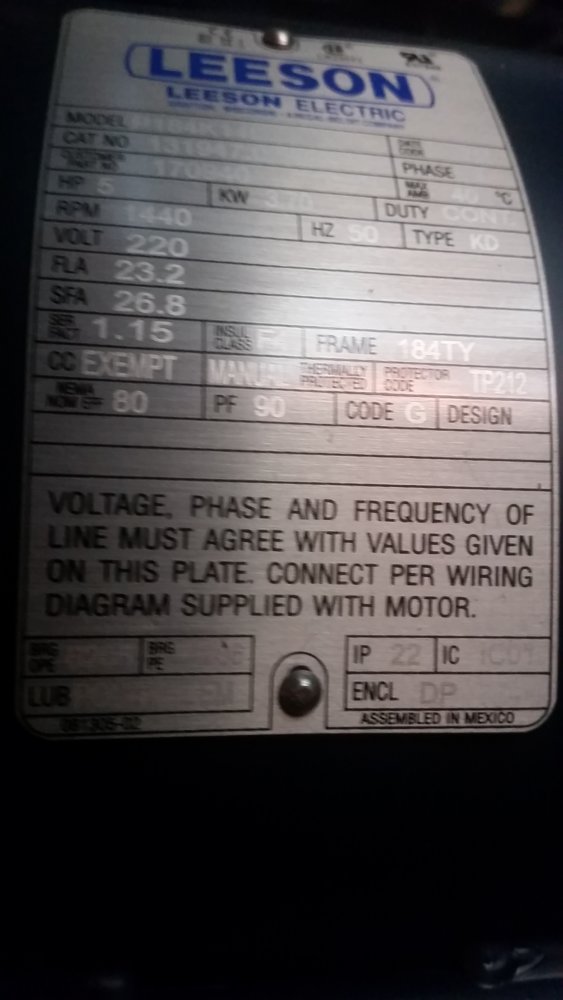

Am checking a fault on someone elses install which is about 18 months old. Customer says it starts and operates ok then he stops to take a break ( it's a small pool with pumped flow to swim against), then tries to restart and the RCBO goes. So, I know it's hot when it happens but that's it at the moment
Wylex 32A C type on the tester goes at 21mA on both cycles and breaks in; x1 29.2/19.1 & x5 8.9/19.1 mS 20200121_183204.jpg20200121_183207.jpg

Whats the pump rating? is there any other load on the device or is it pump only?
Edit, sorry just seen the attached pics which answers the pump rating

Aye, that was my line of thought so far, so Monday I'll get into it better and more measurements. The spec is ok for the RCBO but the motor may not feel that way. The CU is a mess and for a new install there's no paperwork at all...
I don't know if the speed is VFD or inverter, it's a operated from a remote with incremental steps.
The motor is started DOL and runs at constant speed. The variable water flow is achieved by a proportional solenoid valve diverting the hydraulic pump output away from the hydraulic motor.
'Code G' on the rating plate indicates locked-rotor load is in the range 5.6-6.3 kVA per hp, (IIRC NEMA rated hp, not multiplied by the service factor)
Worst case starting current will be 5 x 6300 / 230 = 137A on a C32 RCBO
137/32 = 4.3 x In which gives a tripping time of around 2-10 seconds.
I would assume the pump starts fully relieved by the valve but even so, that looks fairly borderline for tripping on starting current.
