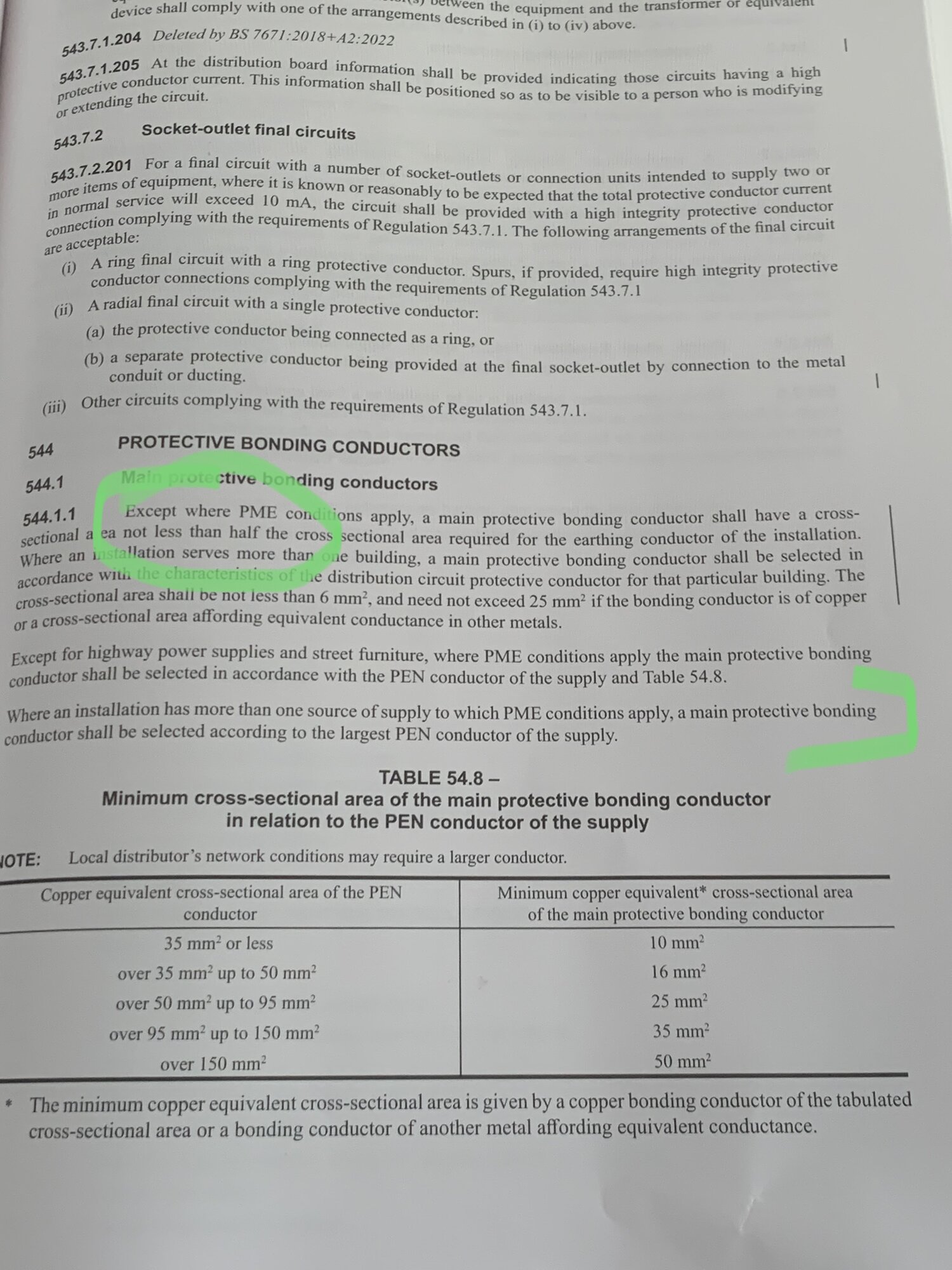

No, it's not the MPBC, it's extraneous conductive part in a remote building therefore the bonding size is dependent upon the circuit to that building.
I have heard of this new Reg but not perused it does it apply to all TN systems.
Yes, it basically means you don't need to size the extraneous conductive part bonding on the incoming supply, but on the supply to the particular building with a minimum of 6mm^2
The rest is the same other than a bit of clarification on what is extraneous - ie not just where a bit of metal passes through the wall!
I think it's poor wording though, it uses "main protective bonding conductor" to mean both the main protective bonding conductor at the incomer (which is based of the incomer size), and for the remote building.
I think "main protective bonding conductor" should be reserved for the incoming aspect and something like "remote building protective conductor " for the remote building.
Just to distinguish between them or else there will be confusion, 'when I say the main protective bonding conductor, I don't mean the main one, I mean one of the other main ones....'

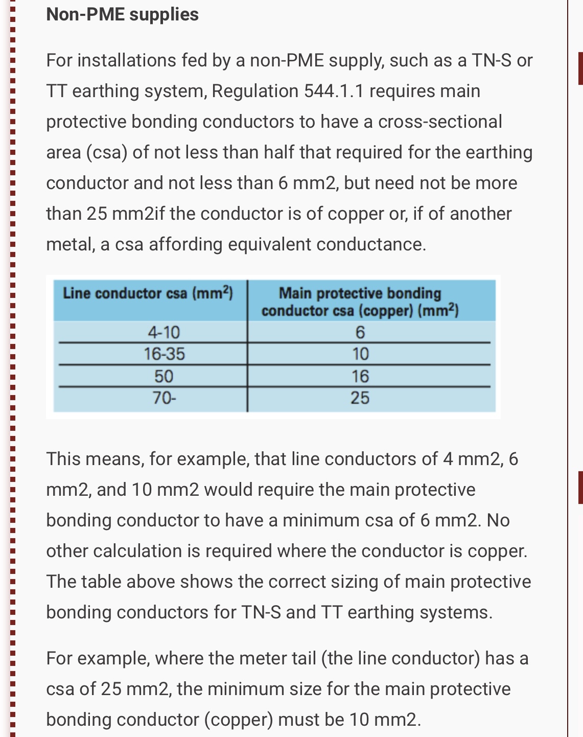

This is new to me too is the reg present in the latest amendment books
This is what I found & only on non Pme supplies
Yes, it is in the current standard (18th edition amd 2.)
We can only follow the old standard (amd 1) for up to 6 months,

Except Pme supplies
If that is the new book I did wonder if it applied to all TN systems.

It is there but is now amended.
Cheers…can’t get to my book yet…having a new bathroom fitted, the house upside down @ the moment
No not except PME, it is except where PME conditions apply.
You should not be applying PME as the CNE will have been split at the header into L, N & E. You should never combine the N & E within the installation.
The note re except where PME conditions apply, was there over several versions of the regs, we would still apply the 50% or min 10mm^2 rule.
In fact there is no sizing for bonding within the (wiring) regulations where PME does apply!
This is usually determined by the utility themselves, and is often 50% or min 16mm^2 for customer service points, and generally 32mm^2 within the network (eg SNE sheath to CNE) even if its to one customer.
I don’t intend to combine N & E..never have…For me it’s gonna be a TT system @ the greenhouse.
Also the 10mm MPBC would apply if using the DNO earth
This has become somewhat confused I asked in #22 if this applied to all TN systems and whilst TN-C-S does not necessarily mean PME I was answered yes it does but it doesn't?
Definitely not apply to TNS
