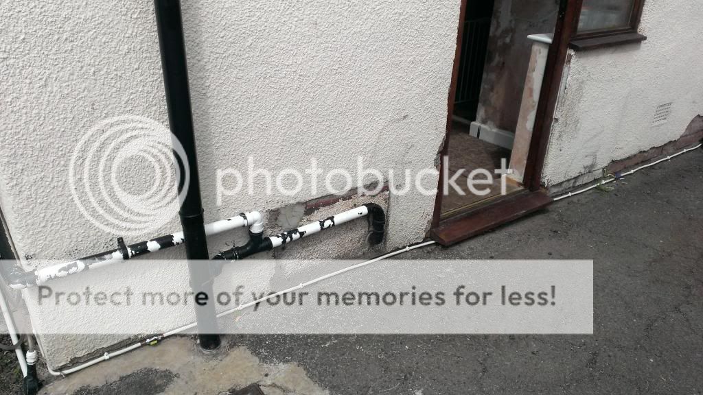

Image #1: Shows external oil stop tap, bonding appearing through the wall, which connects the mains water to the oil.

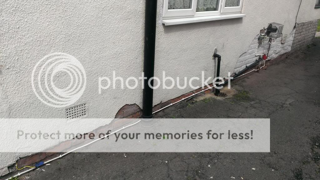

Image #2: Shows a little more of the route of the oil feed, to where the rest of the kit has been mounted.

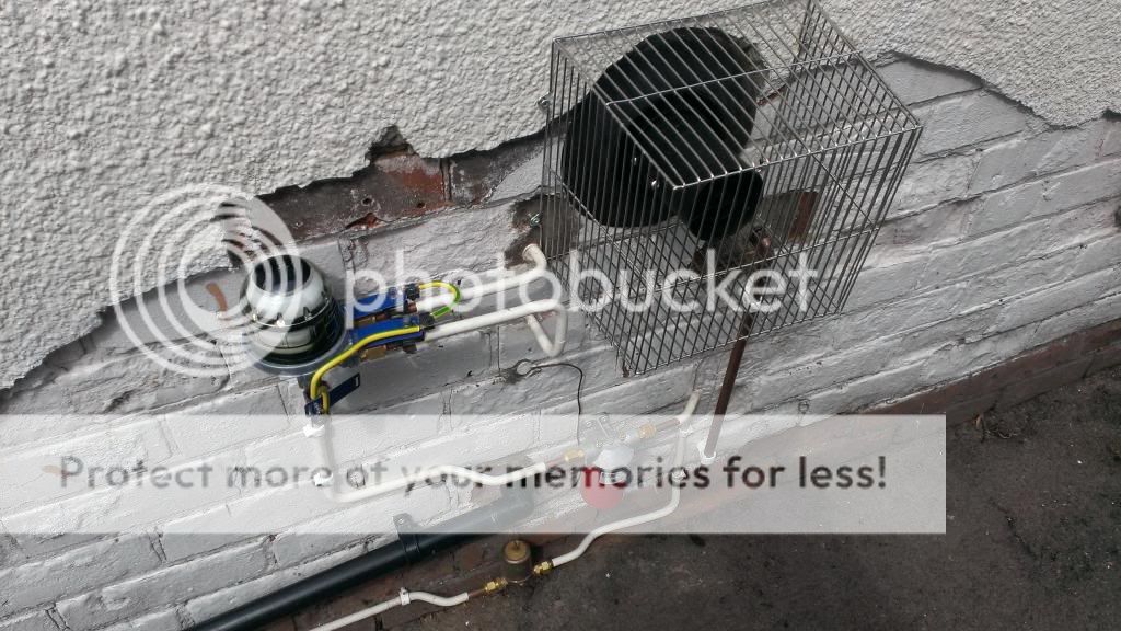

Image #3: Shows the bonding arrangement on the external parts of the boiler system. Top left is the de-aerator, down and round into the filter, and finally at the bottom is a fire valve.

if what concerns you is the extending (or daisychaining) of the bonding conductor from one service to the next....
then its not an issue....as long as the Max. measured value does not go above 0.05 ohm measured from the furthest point (as for any radial)...
the only thing i would perhaps say is if the bonding conductor wasn`t continuous .....that is to say it was cut at each point served...
but as long as good continuity was acheaved....i`d give it a 3 at worst...

the fact it has not been supplementary bonded across the fire valve and filter may be because it doesn't need doing, which is genuinely possible if there is negligible resistance across them.

Looks to me like the main bonding has been adequately installed.although it is preferable for clamps to be within the building rather than external,this may be because of practicalities on site. The only issue appears to be that a minor works cert has been used for a new circuit,and the RCD issue....but are you certain there is a dedicated MCB in the CU for the boiler?....a pic of the cu would be useful.

I would think you have unnecessary supplementary bonding but it's not possible to tell definitively from here.

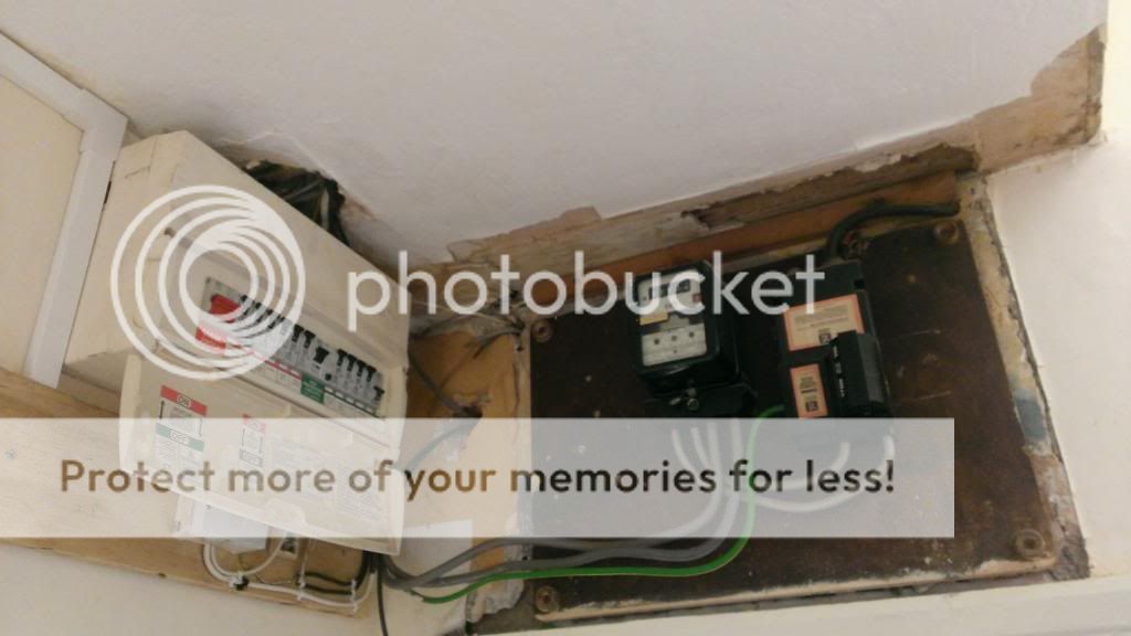

Picture of the CU, the boiler is 6th MCB from the left, labelled "Water Heater", after the Main Switch.
All tools that were brought into the house were in a small brief case style carry bag, so unless a suitable tester is small enough to fit in a standard jeans pocket without being noticed, I doubt very highly that any testing was done.
If the circuit in question is really the one you have stated then clearly you have a jackanory cert as they have given RCD test results when there isnt one...(assuming they have not stuck an RCD FCU somewhere).....Get on to NIC complaints,or otherwise their stated test results can easily be verified by another tester,perhaps there is a forum member locally who could verify?
You stated this is a new circuit.....surely the W/Htr circuit was there before?
If the circuit in question is really the one you have stated then clearly you have a jackanory cert as they have given RCD test results when there isnt one...(assuming they have not stuck an RCD FCU somewhere).....get on to NIC complaints.
My thoughts too
My guess is they used existing water heater circuit via a RCD fused spur unit local to the boiler especially if the boiler replaced is a combi & is close to where the old hot water cylinder used to be. Or the boiler has been located next the the existing hot water cylinder. Either way dont see much wrong with that
Reactions: 1 person
Water Heater Circuit was labelled on the CU, but not installed, as this had previously been removed before we moved in. Heating system has had a complete overhaul. I assume the Water Heater relates to the Immersion Heater that would have been in the hot water cylinder on the old system.
New boiler is located at the opposite end of the house, under the stairs. Originally, it was located just inside the side door, hence the minor building site in one of the pictures through the door. No RCD FCU has been installed, just a basic Switched FCU under the stairs near the new boiler.
