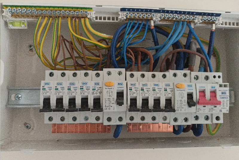

Inspecting and testing a consumer unit as part of my training and have noticed that the circuit breaker for the SPD is on the RCD? I am unsure weather this is acceptable as I haven't come across this configuration and I am pretty new understanding SPDs could one of you more experienced people explain to me why it is or isn't it would really help with my understanding and training.
No, it should not be off a 30mA RCD as it might trip it on a surge.
They are fine after a 'selective' RCD (once common as a TT incomer) as that will ignore short spikes of voltage leading to imbalance current (the sort of thing SPD deal with).
I just asked one of the people I am training with and they said it was fine as this brand of SPD no earth leakage so can be installed downstream of an RCD/ RCBO. Would this then be fine if he is correct?
I hope you also noticed the missing busbar shield and unbalanced load between the two RCDs.
This is an image from screwfix site of that type of board, (BG) where the SPD is through an MCB, not an RCD. I can only assume your board has been retrofitted with an SPD, not original

Surge protective devices (SPDs) should wherever possible be installed upstream of RCD to prevent unwanted tripping caused by transient overvoltages
Also 534.4.5.1

The way an SPD works is by diverting the surge to earth. This will cause a trip leaving the surge free to find another route to earth.
Higher quality brands actually spell out that only a selective RCD may be fitted upstream, e.g. Schneider:
The BG spec sheet doesn't talk about coordination of devices, but does confirm my comment:

This got me thinking; on a TT arrangement with an all RCBO board and no upfront RCD you'd need to provide a suitable RCD for the SPD?
What about boards whose SPDs don't require an MCB for protection presumably they would likely require a suitable RCD for fault protection if installed on a TT supply?
I'm not following your reasoning. Why would you need to provide RCD protection for an SPD?
The SPD type for TT have one device L-N and another N-E to reduce the risk of a L-E short needing some means to clear it (e.g. an RCD up-front). Often they are used in most cases due to the 'safe' arrangement.
The SPD designed for TN systems have all devices from live-E but they don't have the same risk of L-E causing a live installation.
Personally, and due to being a bit paranoid (partly my nature, partly the Voice of Experience), I would use a 100mA selective RCD up-front of an all RCBO board just in case, but if properly installed and correct SPD used then it is not absolutely necessary.
