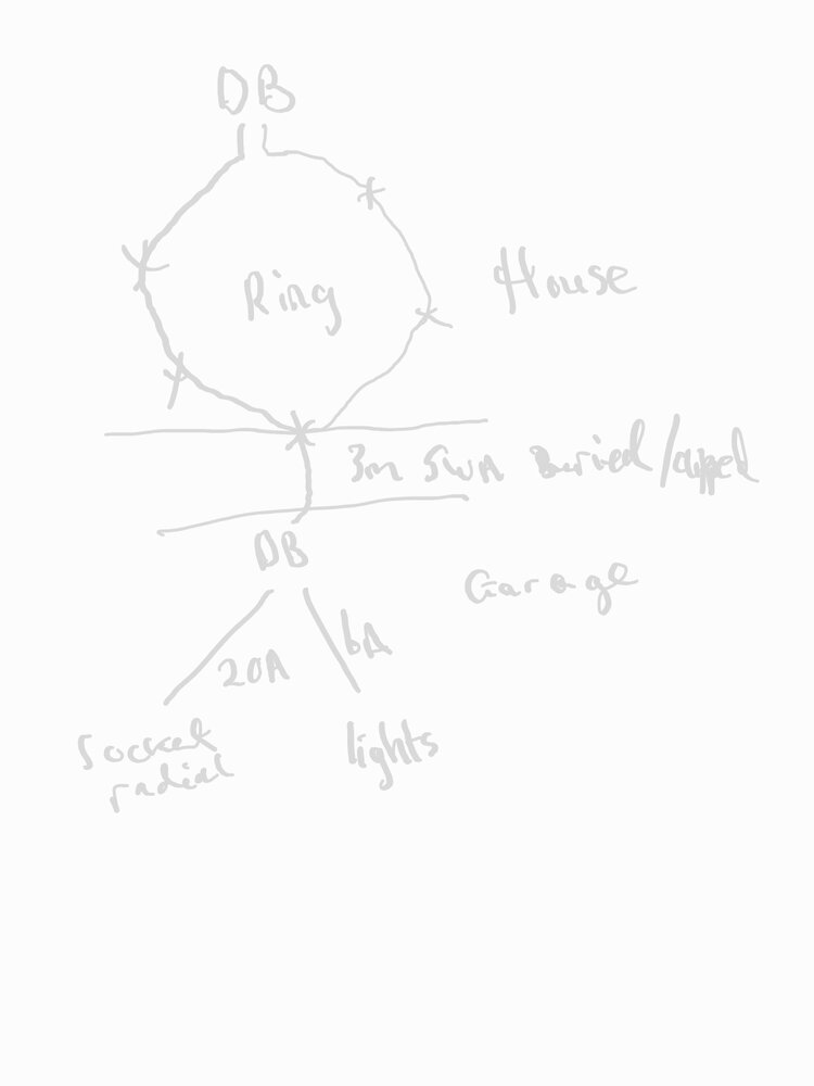

I've come across this setup and although not exactly standard, can't fault it. What are your thoughts. I'm guessing it's just a hybrid/lollipop config.
All cable, including the SWA that runs externally to the garage is 2.5mm t&e.
A socket on the ring feeds an adaptable box, which goes to SWA, underground about 2m then clipped direct about a meter to the garage DB which feeds on lighting and sockets.
A lollipop ring is specifically one where a single larger cable runs from the board to a remote point, where it splits into a ring. What you have is just an ordinary ring with an unfused spur that feeds more than one BS1363 point via the garage DB. It does not qualify as a fused spur because the maximum OCPD rating is either a 13A fuse or 16A MCB, therefore it is non-compliant. One might argue that the total of 26A OCPD in the garage board allows no greater load than two 13A plugs in one double socket fed by a compliant unfused spur, but that is not how RFCs are intended to be used.

Thanks @Lucien Nunes,
In order to make this compliant then, I'd need to advise the 2.5 SWA is fed via a 13A fused spur or ideally, a new circuit run to that point for the garage feed (however this is unlikely to be a realistic option)?
Thanks,
Yes, unless the load in the garage would be expected to exceed 13A. If there is a washing machine or other large appliance in there, or provision for one, I would consider this an inadequate solution as the simultaneous use of one other socket for a significant load such as a heater would exceed the supply and the likelihood of blowing that fuse with a long low overload is objectionable on a number of counts.
The new circuit would be the preferred option, however it's an unlikely one that the customer will go for (it's been brought up and they're not keen). A fused spur would surely suffice to make it compliant?
Either take out the cu in the garage on put in a fuse non switch or walk.a lot of customers say it worked before why change it.
