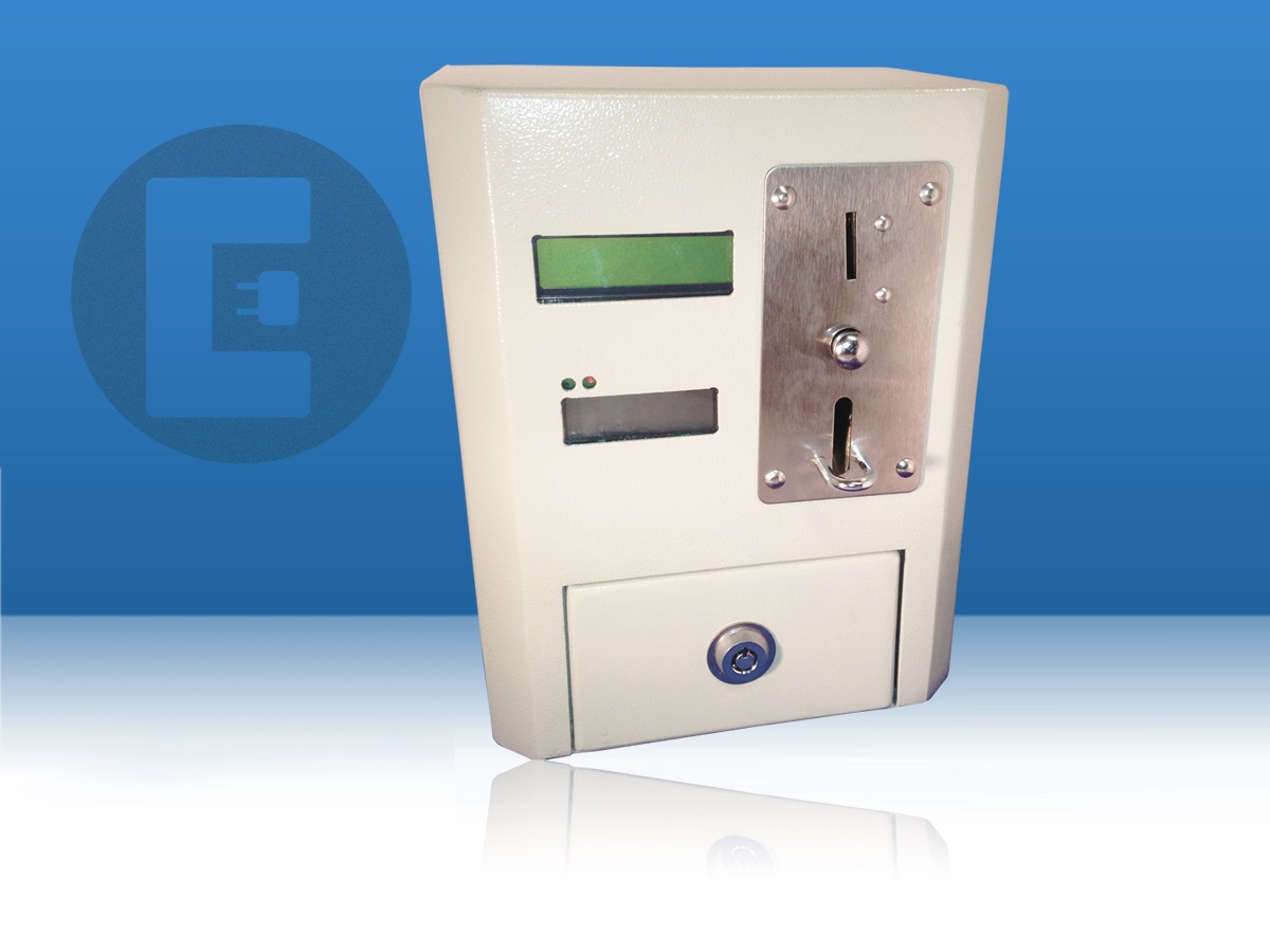

They should fit these pound coin meters to each room haha
Won't cover the common rooms though will it!! lol!!
