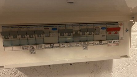

Hey guys,
looking for a bit of advise on the installation of an outside light.
I plan on chasing out the plasterboard and running a cable from a spare light switch in the kitchen through to the exterior (approx. 4.5m away).
The light I have seen is: LAP Weyburn Outdoor LED Floodlight Black 50W 5000lm - Screwfix - https://www.NoLinkingToThis/p/lap-weyburn-outdoor-led-floodlight-black-50w-5000lm/671pg
I currently have some 2.5mm grey twin and earth. The light itself is .75mm cable. Do I need to get some 1.5mm or .75 cable instead? It looks like all the existing circuits are 1.5mm. The circut is protected on a 6a mcb.
Secondly, what is the best way to connect, can i use Wago connectors / terminal block and push in to the cavity, or is it best to use an interior junction box in the wall and connect the flex from the light internally?

Does the light switch have a neutral present.
No you can't shove unenclosed connectors into a wall cavity.
Does the circuit have 30ma RCD protection.

Hey, yes it has neutrals present both from the live input and the other lights coming from it. it does have RCD protection of 6a at the consumer unit.
For the sake of clarity could you post a picture of this?
If its rated at 6A then its and MCB not an RCD. But it may be an RCBO which is a device that combines an MCB and an RCD in the same unit.
It is very important to ensure that the circuit has the correct 30mA RCD protection as this is a requirement of the wirkng regulations and provides you with protection against electric shocks.
Please see attached consumer unit. Ground floor lighting is protected.

Post a pic of the wires at the switch? They may not necessarily be neutral, they could be live I.e a switched live that has not been sleeved in the correct colour. Make sure you switch the circuit off before removing the switch cover though in case any connections are loose.

1.0 or 1.5 T&E from switch to light.
Outside waterproof jointbox onto the flex
Safe zones. You can go straight up from the switch, but it is very likely you will find the cables feeding this switch buried in the wall

Firstly, you would NEED a neutral at the switch (not just a blue or black wire, which is likely a switched live).
Second: You need to run the concealed wire under the plasterboard in a "prescribed zone" (e.g. vertically or horizontally) AND it will need 30mA RCD-protection.
Third: 2.5mm is TOO BIG! (It may not fit in either the light or the switch box). 0.75mm (flex) isn't recognised by BS7671 (and flex wire is frowned upon for fixed installation), BUT 1.0mm Twin and Earth is fine - unless exposed to sunlight, in which case it is NOT OK! A different wire, or conduit, will be needed (although painting the wire, arguably, could provide the required UV protection!)
Fourth: You should ensure the Earth wire is fully functioning (even though the new light may not require it).
Wago connectors, or similar, OR choc blocks are fine for extending the Neutral and Earth (the Live will come from the switch).
Unless all of the above can be assured, I would advise you employ an electrician.
BS7671 2022
Table 52.3: Lighting and Power circuits: min 1.0mm
521.9.1: A flexible cable shall be used for wiring only when the relevent provisions of BS7671 are met (i.e. see above).
Flexible cables used for fixed wiring shall be of the heavy duty type unless .....
So minimum 1.0mm heavy duty, or protected against mechanical damage.
