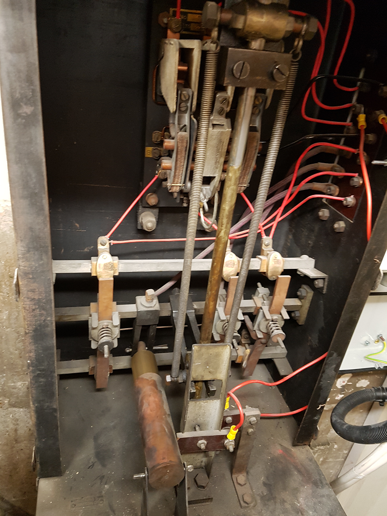

A more comprehensive view. More info:
Does something, then does something else.
Hose connection has to do with timing second thing relative to the first.
Has an interlock to prevent it doing the first thing again until the second has been undone.
Modern replacement doesn't need the hose, has electronic module instead.
Not a lift. Pete's closest so far, there was a slipring version of this with the same basic mechanics but this isn't it. I'll put up a video later when I'm near the laptop. FWIW I was just looking inside a British Klockner unit from the 1960s that uses a Rotherham escapement timer instead of the hose gubbins.
Useful fact: Once this unit has gone through its sequence and the user begins to operate the equipment, it produces something that is distributed into the building through grilles on the wall.
OK it's a water misting system located in the food hall in Harrods. Helps to keep the produce fresh. First cycle starts the pump. Second cycle allows use when correct pressure is obtained.
Well done SC you're spot on. It's a star-delta starter for a 5hp motor on a 4-stage Discus organ blower, that uses pressure from the second stage to operate the changeover. The blower supplies a 1925 Wurlitzer cinema organ in what used to be the New Gallery in Regent St. until the 1950s. It has been a store for years but the organ is still there and is kept in good order although seldom heard. What comes through the grilles into the auditorium is of course not the air itself but music. Vids later...

I should have explained how the starter works. When the blower runs down at the end of a run the actuator rod falls. Its striker engages the slotted black contact operating pawl and pulls it down under the weight of the rod and piston, tensioning the two long springs. Once down, the tips of the pawl lock into the rectangular slot in the catch at the front, holding the three moving contacts (connected to one end of the windings) against the bottom row of fixed contacts which link them into star. To start, the 3-pole line contactor at the top engages and holds, and the blower runs up. When there is sufficient pressure the actuator rod rises and once the striker is clear of the pawl a ramp trips the catch off. The long springs pull it up, rocking the contact bar to open the star contacts and close the delta contacts (connected to the supply) in the top row. The speed of the transition is regulated by the dashpot cylinder to the left of the rod. The ramp holds the catch open and with it, the interlock contact. This disconnects the start button so that if the line contactor is released, it cannot re-operate until the blower has run down and the changeover mechanism has reset to star. I didn't show the stopping part of the cycle in the video as it takes nearly two minutes, due to the huge moment of inertia of the blower impellers.

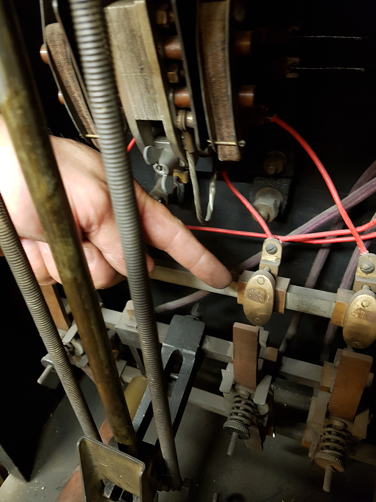

Well it's not often that I get to do a solid week of electrical work these days. Most of my time is office/lab/workshop based, in the field it's mostly electronics. But last week I did Monday to Saturday, six days and two nights, about 100 hours of non-stop-sparking. The main job saw the core team of four of us back together that first worked as a unit doing theatre installations back in the 90s: Richard, Steve, Jason and myself. Anyway I digress, it's not this I wanted to talk about, it's the overnight job.
An old piece of kit on our round (we've got a lot of those) still working but in need of maintenance and in our sights for safety improvements. Not sure when it was installed, I think it's early 1930s but just possibly 20s as it is part of something that was installed in 1925. Peter and I had originally planned to overhaul this unit and upgrade its safety features while replacing the very ramshackle wiring to it that has been modified over the years. However, for various reasons, we decided it was better to decommission it and leave it in situ as a museum piece, and fit a new one alongside. This we tried to do last week but one component on the replacement was damaged in transit so we have to return there tonight to complete.
Let's begin with a pic of a little bit of the inside. I made a video of it before disconnection and this will be online in due course. If you are lucky you will also get to see the whole machine in operation, which is is fine working order. The pink bit is me, pointing out the accumulated wear from 85 years of use.
