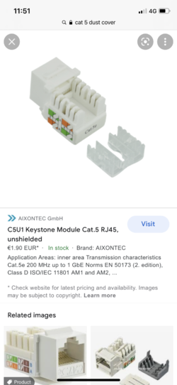

Thank you for your reply.
There was no obvious way to provide strain relief that I could see. It was more the type of set up in this picture although attached to a 1 gang plate rather than a module;62C99BFF-1BAA-4718-AF3B-5C7BC26F6B6D.png
I was provided a wiring diagram for connection which was different to the colours indicated on the back of the cat5 socket but as the specification said to follow all wiring diagrams I went with that option.
Which option, your sentence is a touch ambiguous?
The back of the socket is always the colour code to follow.

I wasn’t very clear was I. I went with the option of the wiring diagram provided in the am2 as the course brief said all wiring diagrams and specifications are to be followed.
I agree with you in the real world that the back of the socket (manufacturers instructions) should be followed but in the am2 they are also marking you for your ability to follow drawings & specifications.
I don’t want to take a re-sit and fail again for the same thing but they don’t give you any guidance as to where exactly you failed.
Given there is only 2 wiring specs for a cat5 outlet ( 568A or 568B ) and in the UK we usually use 568B other than the strain relief I'm not sure how you can go wrong.
If it was wiring the plug as well I know a lot of people who struggle with that
