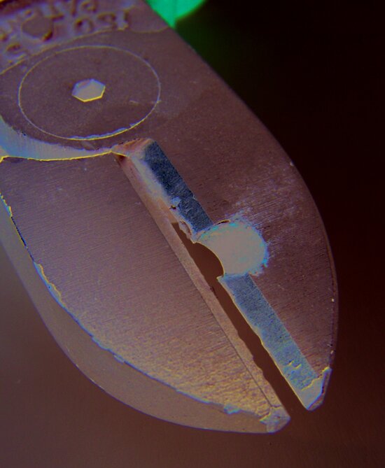

We have received these back from a grateful Electrician and wondered if there are any more examples out there for our collection?
Unfortunately he was injured (but not electrocuted) - the flash caused him to jump and bang his head on a pipe
Any images would be great - Thanks
i would have bought the snips weith the cable stripper holes factory made.
sue the fat plumber for fitting the pipe there.
you see how that coating starts coming off, thats one thing i dont like about these cutters. i love using them but they just dont seem to last. knipex are a chrome looking finish and never get this flaking. i wish ck would make these cutters in the finish of knipex lol. i can send you back my 2 pairs i go through a year if you like! you did send me a free pair in that feedback thing so i suppose i will let you off lol :)

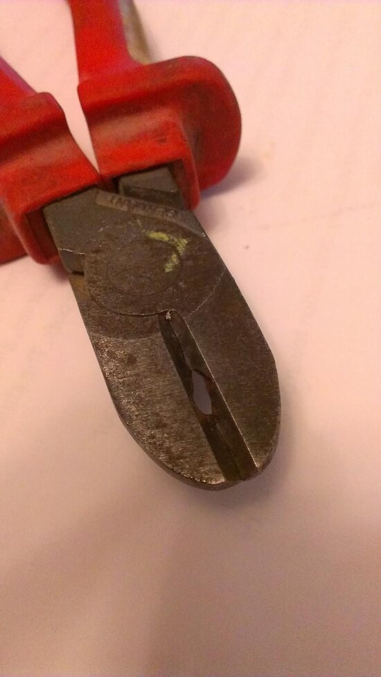

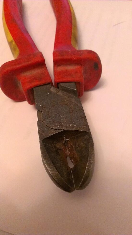

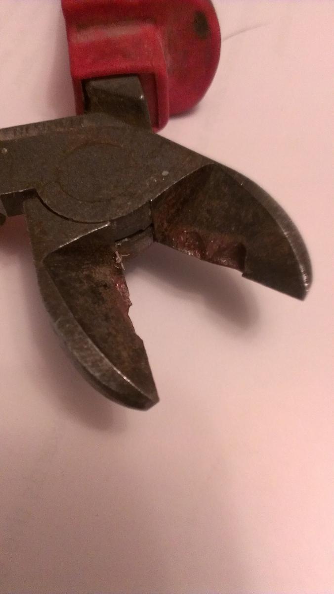

I'll be the first idiot to admit to not following safe isolation procedure. Snipped through a 1.5mm twin and earth feeding a light fitting. Light circuit was isolated, but the cable was tapped from a hidden jb on the upstairs socket circuit.
The vde handles did their job but the blades didn't stand a chance.
Incedently, I could do with a pair to replace these if there are any going spare Mr CK tools ? :rolleyes:
I can see the pieces of copper still welded to the cutting surfaces. It's funny because if you ask a coded welder to weld copper to toolsteel he'll tell you it can't be done. Welders have got a lot they could learn from electricians who don't test for isolation
