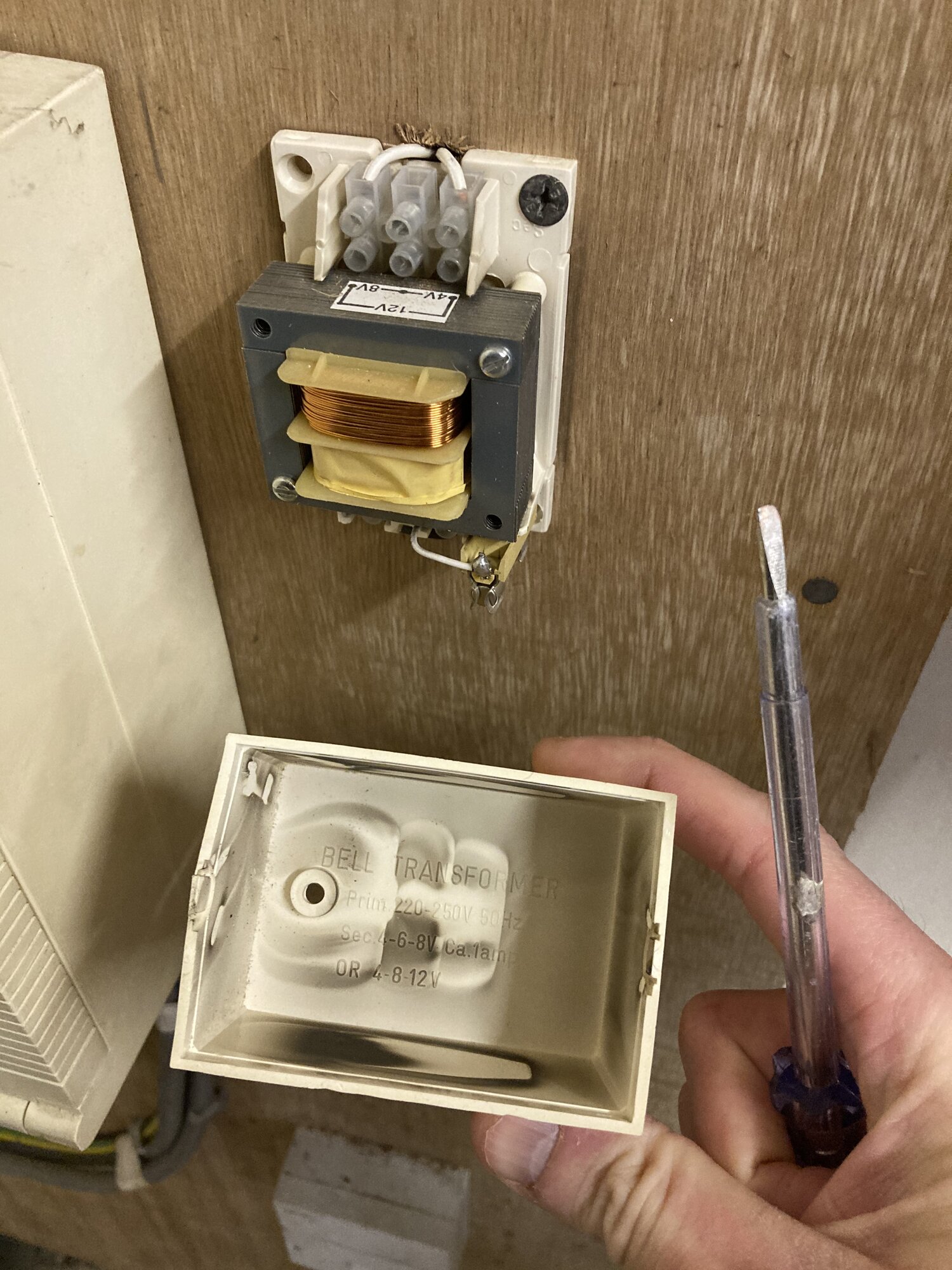

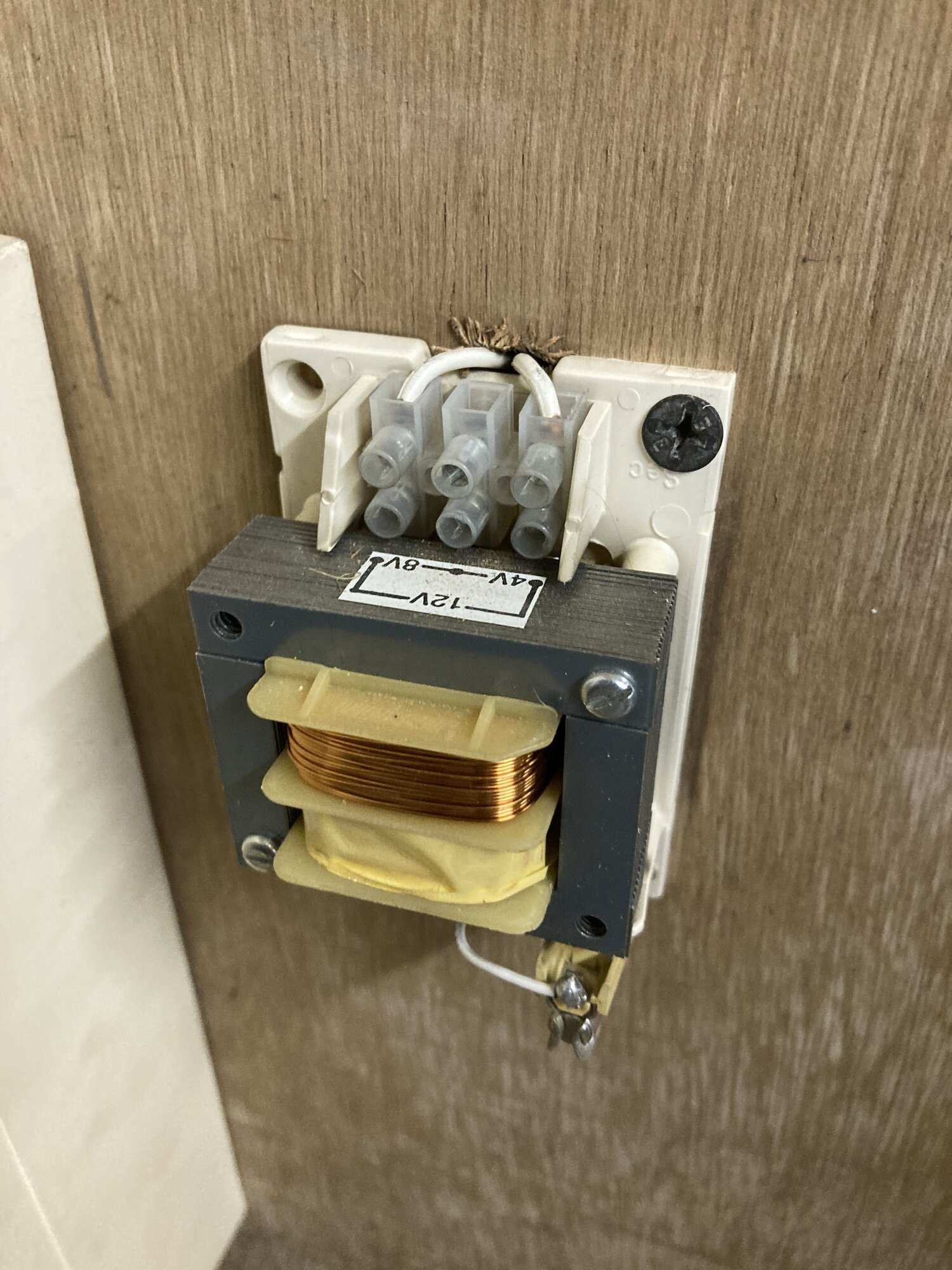

After further investigation I found the transformer next to the consumer unit.

Attached is a photo of my multimeter. I’ve set it to AC volts and probed T1 with T3 and got 16v and then did the same with T1 and T0 and got 16.80v.
I went to the transformer and did the same and got around 16.78v.

16 volts is a bit higher than I expected, though the transformer is off load. Vaguely possible there's something odd going on. Let us know how you get on!
