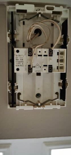

I'm trying to connect a Ring wired doorbell and have a Friedland Type 4 chime. According to the (awful) instructions I need to use the bypass cable and attach 2 of these wires to bypass the chime. Would someone have a look at my photo and tell me which wires to join? Is it the ones going to 0 and 3? There isn't one going to T2 so that narrows it down 🙂
Thank you in advance

Yes, the instructions from Ring just make a simple task appear complicated, so should be placed in the bin. All you are trying to do is to connect the two wires from the transformer directly to the two wires that go to the original bell push, taking the old chime completely out of circuit, but including the 'link' wire supplied, which I think is an inline fuse.
In your case, disconnect 0 and 3, and join them together via the two Wagos and the link wire. This leaves the other two wires still connected to the chime at terminal 1, which is fine, but if you want to remove the chime altogether, just disconnect the wires from one and join them together with another Wago or a piece of 'choc bloc'.

Thank you Brian, worked perfectly!
