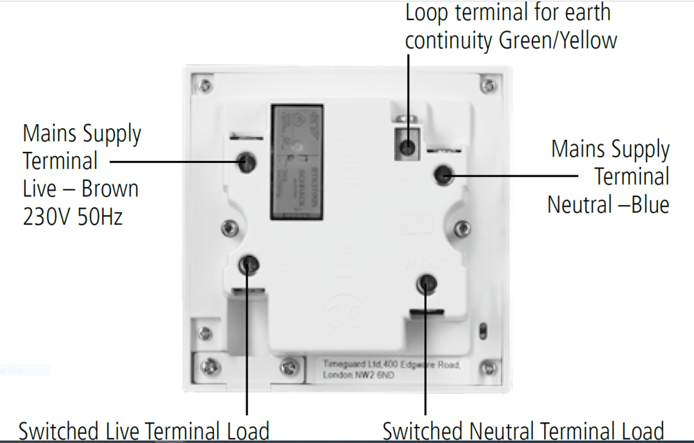

Looks to me like you have mixed up N in and E terminals.
In which case, I'd expect it to trip the RCD as soon as you try to switch it on!
Oh, and you really can't have that much bare copper showing on the output L cable.

Yes! Now I can see what me stupid done.thank you!
