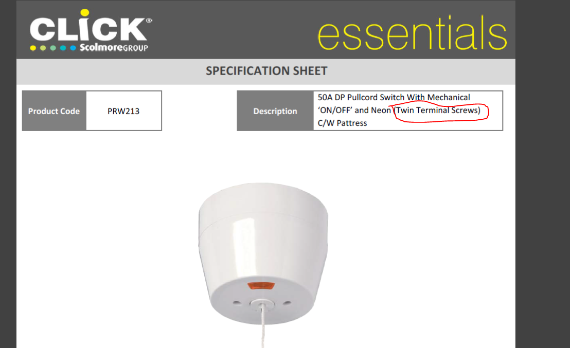

Hi,
The shower pull chord switch has snapped at my mom’s home and having unscrewed the switch I discovered a horror show(see pic). So I’ve had cut the wires back to clean them up but having done so it’s left me with nothing reasonable to wire up the new switch.
There’s nothing left on the cable to pull through and access to the loft in this very old dwelling is going to be an epic so re-routing isn’t really on the table.
Could I use some SpliceLine in-line wire connectors to extend the wires and if so would the 32 amp ones cut it?
Any advice would be greatly appreciated, thanks in advance.
