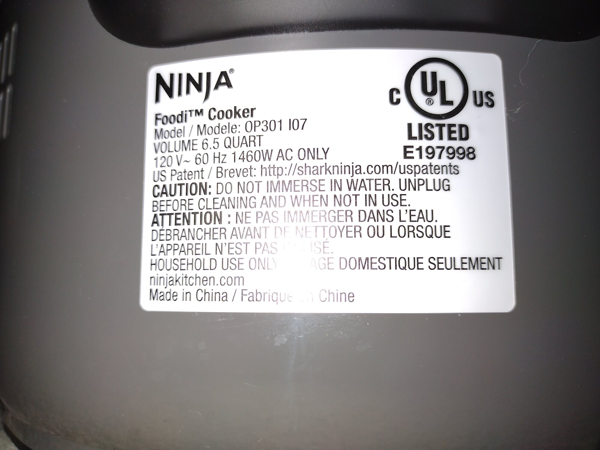

I have a ninja foodie air fryer. I've been already felt with customer support, but this was beyond their abilities. When I hit start it runs for a moment, stops, displays "FooDi", and then turns off. Sometimes it runs properly. I haven't found any mention of that error online. Thoughts?

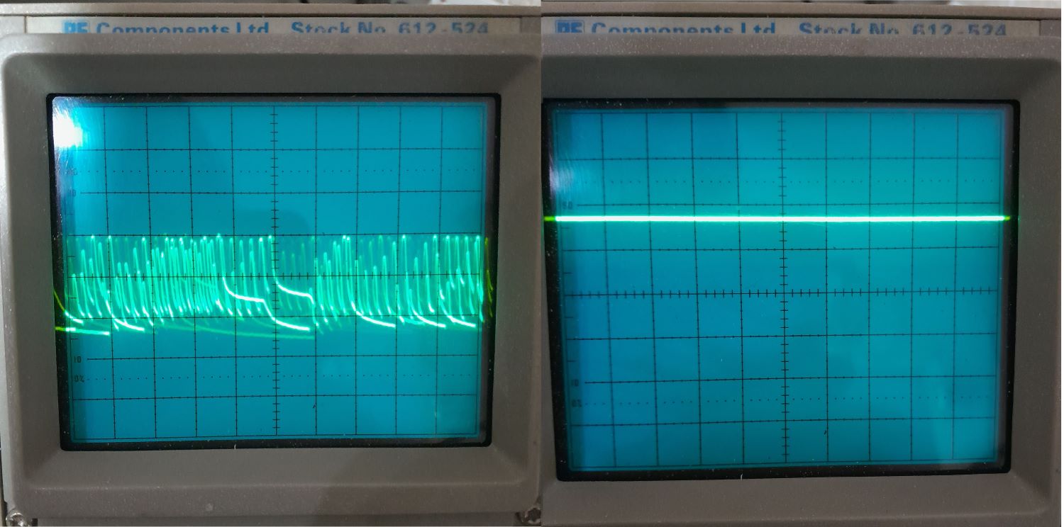

I recently repaired a food steamer with a similar problem, some times working, sometimes shutting off. The fault was a failed electrolytic capacitor in the power supply. The excessive ripple on the supply was upsetting the electronics. See oscillogram of supply rail before and after capacitor replacement.
